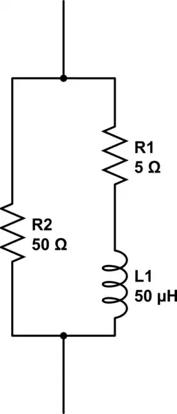

If you post the datasheet that you're reading I could answer it with more confidence, but what you wrote here can be read as a \$50 \ \mathrm{\mu H}\$ inductance in series with a \$ 5 \ \Omega\$ resistance and all that in parallel with a \$50 \ \Omega\$ resistance. Like this:
schematic
