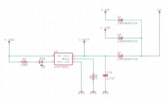

My daughter and I are working on a PCB for next year's pinewood derby car (I call it the Carduino). It's base on the ATmega32U4. I'd like to be able to use the same schematic for Christmas ornaments this year. So, to be flexible, here's my plan.
I added a tag-connect footprint for flashing the Arduino bootloader onto the AVR; that footprint includes a power pin I called V_ISP.
I added a USB port which provides power on a rail I called V_USB.
Finally, I have a battery port for V_BATT.
I tried to protect each of these with Schottky diodes and if the USB power is present, it should charge the battery and power the device (and allow you to flash the AVR with firmware).
Power and Charging

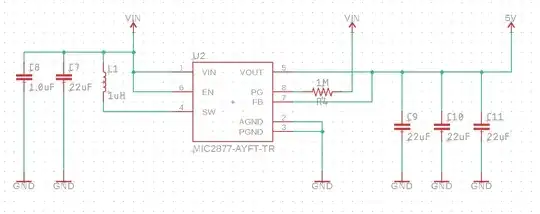

We have WS2812Bs on the board so we need a 5V rail . . . and I want to run the AVR at 16 MHz. So, I have a boost converter to get the input voltage (I call V_IN) to a stable 5V. Then I LDO it down to 3v3 to power accessories (like an accelerometer).
Today I read that the USB power rail can have a maximum capacitance of 10uF! My boost converter has a 22uF capacitor on the V_IN line which I assume would contribute to the capacitance of whichever power supply is providing power.
First of all, am I doing this all wrong in the first place? Will the 22uF cap on the V_IN line exceed the capacitance limit of the USB port? What's the right way to do this?
Thanks!!

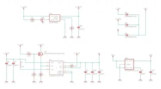

Edit: The New Version
Here's what I have now. I'll come back and update this question once I figure if it works or not. :)

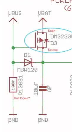

The OP's circuit here will work if you just need the USB to override the battery whenever the USB is plugged in. It prevents the USB from injecting current into the battery. It is simple but does not accommodate battery charging:
Is this MOSFET upside down?.

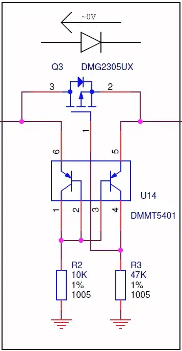

Lastly, this here makes a true ideal diode with an PMOS that behaves in the way you take for granted with a real diode where any and all reverse currents are blocked irrespective of circuit voltages, and does generally work in two-supply situtations:
Understanding an 'ideal' diode made from a p-channel MOSFET and PNP transistors
You do not need this last one for your battery-USB function if you just need the USB to override the battery and not discharge into the battery. The first circuit works for that. But the very first circuit might not be applicable if you want to actually have the USB run through a charger for your battery. You may very well need something like this then.

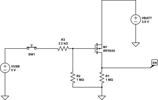

  • That is indeed the primary reason I had the USB power rails going into the boost converter (the battery obviously needs to be boosted). But, I could achieve the same result I think if I put the USB power after the boost converter and then use a MOSFET to turn off V_BATT when USB power is present.
    I suppose I could probably just use a MOSFET and pull the EN pin on the boost converter to ground when USB power is attached.
    – D. Patrick Jan 26 '22 at 22:48
  • @D.Patrick You might also just be able to get away with a 1 Ohm resistor in series before the capacitor to limit the surge current. – DKNguyen Jan 26 '22 at 22:51
  • Oh man. That's interesting. That's something I'm gonna have to look up. Basically, the board's gonna struggle for power during startup while all the caps load up right? But, there won't be a surge of power demand on the USB port? – D. Patrick Jan 26 '22 at 22:54
  • @D.Patrick Yeah. The other possibility is that the capacitance can't be too large or the regulator inside the USB becomes unstable but I don't think that's an issue. NTCs also exist which reduce resistance as they heat up but the low resistance state might still be higher than you want. There are also other solutions like plugs or switches that initially have a resistor connected but then short across it later to remove it from the circuit. – DKNguyen Jan 26 '22 at 23:14
  • I added a schematic to the question with the belief that it is taking into account your recommendations. Does it look accurate? – D. Patrick Jan 27 '22 at 14:10
  • @D.Patrick What is R1 for? – DKNguyen Jan 27 '22 at 14:11
  • Pulling EN to ground to disable the boost converter when V_USB is connected? Although, there's a decent chance that's what's happening inside the IC . . . so maybe that's redundant? – D. Patrick Jan 27 '22 at 14:13
  • Oh I think I misunderstood your intention there. Is this just supposed to disable the boost converter when USB is connected? – DKNguyen Jan 27 '22 at 14:15
  • Yes. This particular boost converter has a "bidirectional true load disconnect" when the EN pin is grounded, so I was thinking this would be an effective way of switching off the battery load when USB power was provided. Although, I think I might need a (forgive me . . . this phraseology may be incorrect) discrete circuit to do this anyway because of the large capacitance on the VOUT side of the boost converter. I may be in over my head on this one. :-/ – D. Patrick Jan 27 '22 at 14:19
  • @D.Patrick Should work...as long as the boost disables faster than the caps try to charge. – DKNguyen Jan 27 '22 at 14:21
  • Thanks @DKNguyen. I think that this is probably my best bet. I think I'm going to disable the boost converter when USB is attached. I think I'm still going to diode isolate the VUSB and VISP inputs. I can run the AVR at 4.6V and I can run the WS2812Bs at 4.6V as well. I'm also going to have to put a diode on the output of the boost converter so that the USB power rails won't have the 66 uF of capacitance on them. That'll drop the boosted voltage down to 4.6V as well . . . but . . . meh. – D. Patrick Jan 27 '22 at 15:29
  • I'm implementing this change @DKNguyen, but I wanted to make sure I knew what you meant by, "as long as the boost disables faster than the caps try to charge." V_USB is not on the supply side of the boost converter at all anymore. Even if the boost converter disables slowly, that wouldn't impact the capacitance on the USB power line, right? – D. Patrick Jan 27 '22 at 21:33
  • @D.Patrick I was wrong. The thing I was thinking about was if your boost was ready to go due to the disable signal defaulting to be enable so when you plug in the USB with no battery (since if the battery was there the boost would already be running and the boost output cap would already be pre-charged to 5V so no inrush) . But I forgot your converter was Active HI so your pulldown defaults it to disable which means it's impossible for the boost to try and race your disable circuit on power up to see which one is faster. – DKNguyen Jan 27 '22 at 21:44
Yes, having a 22 uF capacitor will violate the specs that say max 10 uF.
However, if you limit the inrush energy to below the allowed energy vs time curve, then you can fill a larger capacitor slowly. But you will be instantly powering the whole board and all the capacitors via schottky diodes, all while charging a battery, so total surge needs to be taken care of.
If you only intend to power up the board, with a power supply with USB connector, it might work fine. However, hot-plugging it, or connecting to power supplies that can't handle the inrush current, may have problems starting up.
