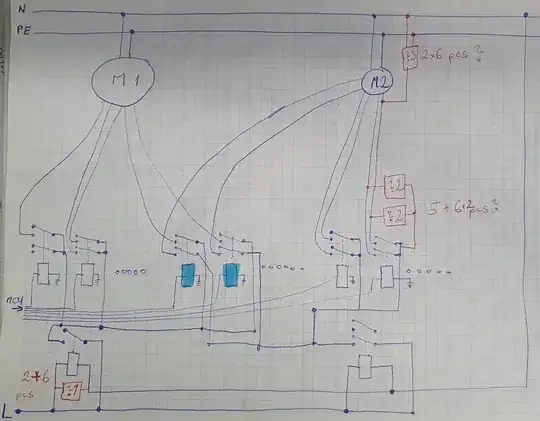

Trying to make motors control, but have very significant influence of the motors between each other. When first motor is stopped (by built in limiter) second one (stopped) start turning cca 1/4 of turn (ignoring built in limiters and can create lot of damage). The relays wiring and MCU commands are correct, tested many times, with one motor everything is perfect.
My assumption is that there is problem with the motors creating strong feedback voltage. I have read a lot about RC snubbers, but have seen at least 10 ways of calculation, leading to different results and do not know which one is correct. I here someone who can help with designing such a circuit? Will the circuit help at all?
Please have look at my schematics below. (only 220V part displayed) enter image description here Relays (even the MCU ones) always have 220V coil and also contacts. MCU switches them via own relays not displayed in schematics. Blue marked ones are common, because if not having the correct signals can result in physical damage so I do not want to rely on MCU and SW.
Motors have cca 0.55A when operating but depends on which wire you drive (I see variations on multimeter, but have no osciloscope). Motors are controlled by switching live to one or multiple inputs and have own position switches build in that are part of hw layout, have no documentation and can not be accessed (in schematics not displayed they are inside the M1, M2 circles). Relays have contact capacity of 10A so it should be fine.
The red markings ?1(coil), ?2(contacts), ?3(motor) represent positions where maybe RC snubber is needed, but have no idea where and how to design them. Should they be capacitor + resistor or TVS... Varistor I do not want as they degrade over time. Relays change position cca once in 5 min, but I need it to be robust, do not want to hear about it for next 10 years :-)

  • I’d suggest varistors across the relay coils and across the contacts. Sure varistors degrade but I’ve had ones out in the field for over 15 years. For RC snubber capacitors, use X2 rated mains caps. They are designed to fail open circuit. They too degrade over time. – Kartman Jan 18 '22 at 10:02
  • For the degradation reasons my favorite would be diode TVS. Should it be cap I'm aware of the X2, but I'm surprised that they fail open, I have seen that they fail short and all failed capacitors I have seen have failed short. Can you post some link so I can learn more about this? – Peter Novotny Jan 18 '22 at 14:57
  • Out of the three choices, TVS diode is most likely to fail short. MOVs and capacitors tend to be much more robust. Maybe you want a Y class capacitor? Allen Bradley/Rockwell Automation and others have app notes on various suppression techniques with relays and contactors switching motor loads. – Kartman Jan 18 '22 at 20:30
  • I can't see a single flyback diode anywhere. – Lundin Jan 19 '22 at 15:59
Based on below links I decided to use C=0.39 uF and R=420 OHM.
Can maybe someone give me hint what is difference between these 2 caps? B32033A4394M000 Y2, 350V and MKP385E4392BJPM2T0 800V, the first one has Y2 rating, but all parameters are significantly worse than second one. Everybody recommends Y2, but what is the reasoning behind when much better versions exists (from my amateur view)?
As resistor I have chosen this one ROX9J430R 9W,750V.
Any opinions about my choice?
Links used for calculation: https://sciencing.com/design-rc-snubber-12030206.html https://www.edaboard.com/threads/calculation-the-power-of-resistor-in-a-snubber.293843/ https://www.mathforengineers.com/AC-circuits-calculators/current-and-voltages-calculator-for-series%20RLC-circuits.html https://forum.arduino.cc/t/help-a-newbie-pls-rc-snubber-values-for-240v-ac/694211/5
