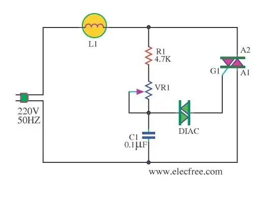

One possible solution is to replace the potentiometer in a triac dimmer with a fixed resistor or trimpot. A typical triac dimmer schematic looks like this (often with some EMI-mitigation components- image from here):
There are other ways, but it would be easiest to use an RMS-reading multimeter to easily set the pot to the correct value (a cheap average-reading meter will give a dangerously wrong answer).

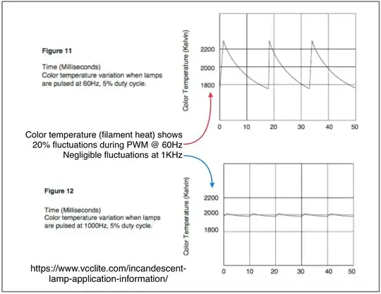

Lamp Filament can show instantaneous temperature fluctuations as high as 20% - that also reflects as Lumens, or the MSCP (Maximum Spherical Candle Power). To avoid this brightness fluctuation or “sub-flicker”, the frequency should be much higher than 60 Hz - The article mentions frequencies as 400Hz, where 60Hz and 1000 Hz are illustrated here:

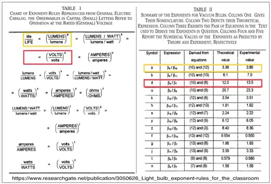

Life of Filament depends to Power 12 of (ratio of Voltages)
and Power 3.5 of (ratio of Lumens), as seen here: enter image description here
\$ \frac{Life_1}{Life_0} = [{\frac{Volt_0}{Volt_1}}]^{12} \$ ; and \$ \frac{Life_1}{Life_0} = [{\frac{Lumen_0}{Lumen_1}}]^{3.5} \$ , Exponents and Ratios are highlighted in color - see picture.
Article references are marked inside each picture, and the complete Power Ratios were posted as can be interesting to someone else.
As Triac-dimmed voltage behaves as a PWM control at 120Hz, and instantaneous voltage will reflect as an instantaneous higher MSCP, life will be significantly shorter, even if perceived average luminous power is the same. So, the same MSCP will have +10% of instantaneous MSCP and will reduce service life to 70% - obviously, using the above modeled & tested data.
I’m just saying a dimmer here is not enough, being an excellent method to lower the light of properly rated lamps. But, for an expensive (and special) incandescent lamp, the smoother and more sinusoidal the voltage is important for filament life. A Triac-dimmer mimicking the average light output could be ok for a common lamp, or when a redder color is acceptable and moreover, it is much more compact than a transformer. But a dimmer would just attenuate the shortening of Filament life that continues to be reduced if the dimming adjustment is made to the same perceived color temperature.

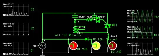

The best-case is to use a dimmer that starts from 0 and ramps up to 90 deg max.
Transient failure is very likely
  • Using the model of 100 W bulbs for 120 V, 60 Hz and 240 V, 50 Hz with the worst-case turn-on Vac at 90º , the 240V bulb will draw 4 kW peak and the 120V bulb will draw about 16 kW peak. Typically a random phase start current is 10x but the worse-case is starting at peak voltage and cold resistance.
  • Best-case is 0 deg start the proper-rated bulb voltage the peak power = 6.8 x rated power. These are significant factors that shorten lifespan and your experience of seeing a bulb burnout at turn-on, more often, may validate these factors for you.
Steady-State will shorten lifespan and be hotter.
  • the 120 V bulb with a diode will be 4821 ºK , 173 W or 1.73 x rated
  • the 240 V bulb will be the normal warm 2400 ºK, 100 W.
The better solution is to use a dimmer that always starts at 0 Deg phase after a power interruption and ramps up to 90º limited by Rpot.
updated Simulation proof Added slider for resets 0 to 90 º phase.
Although bulb failure is a combination of heat, age and peak force=current, the 240 V Triac will produce the 6kW peak worst-case if not started from a lower power than 90 º.

  • If the OP is going to use a dimmer then choosing one with soft-start may be an option, also trailing edge rather than leading edge may be kinder to filament lamps, although the OP doesn’t state the type. – Frog Jan 18 '22 at 19:40
  • I agree @Frog good advice but then inductive spikes might occur if it is a ballast type – Tony Stewart EE75 Jan 18 '22 at 20:25
  • Tungsten Filament melts at 3695K. Regular lamps operate at 2300K-2800K, Photoflood lamps operate at 3200K-3400K range, lasting just few hours. Simulation results above melting point, as stated 4821K, shows the model of the component (lamp) is not adequate to be extrapolated, at least. – EJE Jan 19 '22 at 17:34
  • Good point @EJE I am surprised the Op didn't exclaim the obvious change in illumination or even the type of lamp. Hmmm – Tony Stewart EE75 Jan 19 '22 at 21:42
