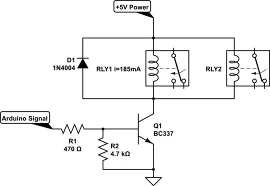

Arduino cannot drive a relay directly, so you need a transistor driver to interface the Arduino and the relay. This is what you asked, similar to what @Momo sketched, but with TWO major changes - a Diode and an additional Resistor:
schematic
  1. A Diode reverse-biased on the coil to protect the transistor from voltage spikes that happen when you turn the coil off. Here a 1N4004 or any other rectifier diode works.

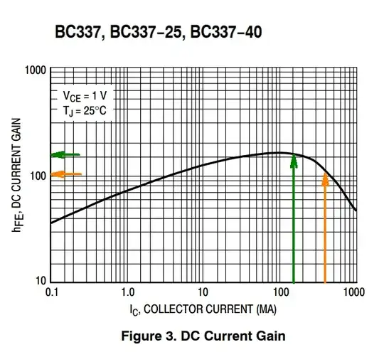

  2. Transistor-driver should avoid erratic operation and require a lower current from Arduino ports. Arduino's absolute maximum is 40 mA per port, but limiting to 10 mA is recommended. I limited here to 10 mA per port, using R1 = 470R resistor. An additional R2 = 4K7 avoids the erratic operation of the relay if the Base terminal is disconnected from Arduino, or it is configured as Input (with high impedance). Transistor should drive at least 500mA and BC337 has Ic_max = 800 mA, with Beta/HFE/Gain = 100 at Ic ~400mA. See the picture below, with orange arrows. However, I would prefer to do the other solution, ahead. BC337 HFE per collector current

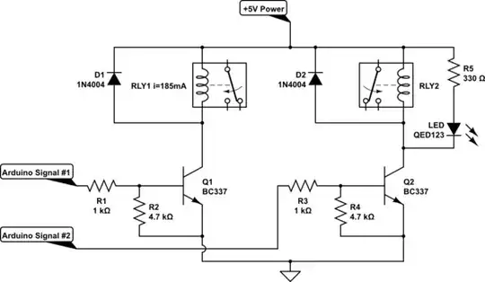

As the relay is the most expensive part of your hardware, I suggest you play safer and double the driving circuit, connecting them as follows:
schematic
simulate this circuit
In this case, the required current for each Port is 5 mA (as R1 = R3 = 1K) and each BC337 transistor operates less stressed, at ~200mA. The BC337 at this current has HFE ~200 (pictured Green arrow), where (HFE * Ibase) > Ic required by relay, enabling transistor saturation and lowering Vce, as properly explained by another post here.
Driving Both relays: Port #1 and Port #2 could be connected in parallel, to the same digital Out pin of Arduino. I also added a LED on the second relay to illustrate a visual indication, in case you wish a direct visual confirmation of the relay being driven.
Relay operation with Arduino and NODEMCU at 3.3V levels:
In the future, if you wish to operate them separately you could drive them easily. In case one wishes to use ARDUINO and NODEMCU versions that are powered at 3.3V, the above driving circuit works without major modifications, except LED should be red-colored (Vforward < 2.0V) and R5 should be lowered to 150R. Then, power the "+5V" separately and use the common GND, driving terminals #1 & #2 by their 3.3V pin ports.
