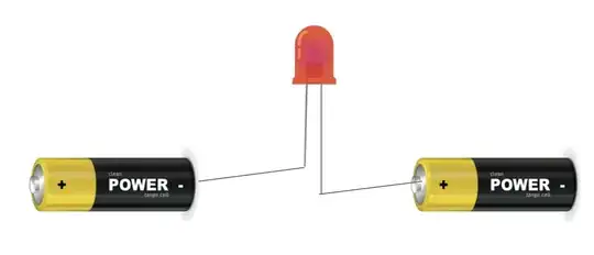

I know this is a very beginner question but I'm not even sure what to lookup to learn about its details, so here it goes.
Why won't this turn the LED on? does't the current flow from positive to negative?
Why can't positive side of a battery move to the negative of another battery?

Current flows in closed loops.
You need to create a closed loop for current to flow.
You can connect things, one to the other, end to end (in 'series'), all day long, but until you close the loop no current flows (ideally).

What you are doing is in violation of Kirchhoff's circuit laws. You need to create a closed circuit for electrons to move or for current to flow. Which means you have to connect the negative side of the right battery to positive side of the left battery. This way current can flow. Something like this: enter image description here

  • right, but the question is why wont it flow in mine? how does the electron know the other end is closed or not? doesn't it just want to move to a negative side? – gedako Jan 15 '22 at 05:00
  • @gedako You need a reference node (GND) so other nodes can be defined by them. In your circuit you can't really say which node has a higher value in volt since the circuit isn't closed. – Momo Jan 15 '22 at 05:26
  • @gedako Maybe this can help you: https://electronics.stackexchange.com/q/2440/303288 – Momo Jan 15 '22 at 05:29

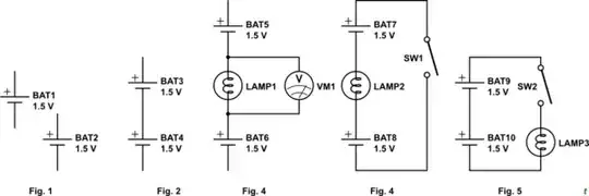

  1. Two independent batteries floating in space. There is no reference between them. No current can flow. Connecting a meter between the batteries on either end will give a reading of zero volts.
  2. The batteries are connected in series. There is a 3 V difference between the top and bottom. In your proposal the batteries should go flat immediately because the the charge would somehow go from one to the other.
  3. Here's the same situation but rather than a direct connection a lamp has been wired between the cells. Since no current flows the voltmeter reads 0 V.
  4. To allow current to flow a closed loop must be formed. Here when SW1 is closed current can flow and the lamp will light.
  5. The circuit of Figure 4 rearranged in the more conventional flashlight arrangement.
Because the overall charge in the battery must remain the same. If current leaves one terminal (forget about electrons - just think of conventional current flow from positive to negative) then the same current must come in the other terminal. With any break in the circuit that can't happen.
If what you proposed could happen then the batteries in a flashlight would go flat very quickly after insertion even if the switch was open.

The dumbed down answer is that the two unconnected batteries have no relative voltage difference. The positive of one battery and the negative of the other battery are at the same voltage potential, so there is no movement of electrons. They do not know they are connected because they both see everything equally.
When you finish the connection, a difference is created and current exists due to the different voltage levels.
