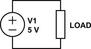

It does not lead to a contradiction in circuits where KVL is still applicable. KVL states that the voltage around a loop shall be zero, and a simple circuit where this model is useful looks like this:
and indeed, the voltage around the loop is zero - there's a voltage drop of 5 V across the load.
There is a KVL contradiction when you apply a short-circuit to the ideal voltage source, or if you connect two different-valued voltage sources to the same nodes. These are artificial contradictions, simply because you've chosen an oversimplified model (ideal voltage sources and/or ideal short circuits). This does not mean that the model is universally bad, since it still held well when we had a real load, but it does mean that the model has limitations.
