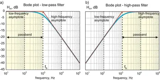

As for the dividing by \$\sqrt2\$, this relates to the half power points of the spectrum that you uncover in your experiment. Here's a simple magnitude bode plot of a single-order low-pass filter: -
Picture from here.
A signal that falls to 3 dB below its nominal maximum level level is said to have reduced in power by 2. Consider this; if the original signal was 10 volts at its nominal maximum level then, the power associated with that signal into a 1 Ω load would be: -
$$V^2/R = 100/1 = 100\text{ watts}$$
Half the power level would be 50 watts and that would be a voltage of: -
$$V = \sqrt{50\text{ watts}\times 1 \text{ ohm}} = 7.071 \text{ volts}$$
Or, put another way 10 volts divided by \$\sqrt2\$
And, in decibel terms that's 3 dB down on 10 volts because 20 log (7.071/10) = 3.01 dB. Yes, 3.01 dB is strictly speaking the half power point but, as engineers we refer to it as the 3 dB point.
A friend of mine told me something about choosing voltage values at which distortion does not occur at the output signal. Also would appreciate a comment about this.
You should use your oscilloscope to ensure that the op-amp output does not visibly distort when making measurements in your experiment. Distortion is not your friend here (unless you are a guitarist) and, it can skew the 3 dB points a little if you are not careful about managing things correctly.
Here's another 2 bode plots (of a single-order low-pass and high-pass filter) with a little more information: -

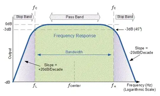

Image from here. The point of showing the above is that for many op-amp circuits, there can be two 3 dB points; one at a low frequency and one at a higher frequency. Think audio processing circuits for example. So, you might end up with an experiment that produces a magnitude bode plot like this: -
Image from here.
