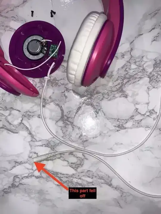

I am trying to replace a broken head phone wire (with three terminals).
Here is the overview of the headphone, showing the broken part: first pic

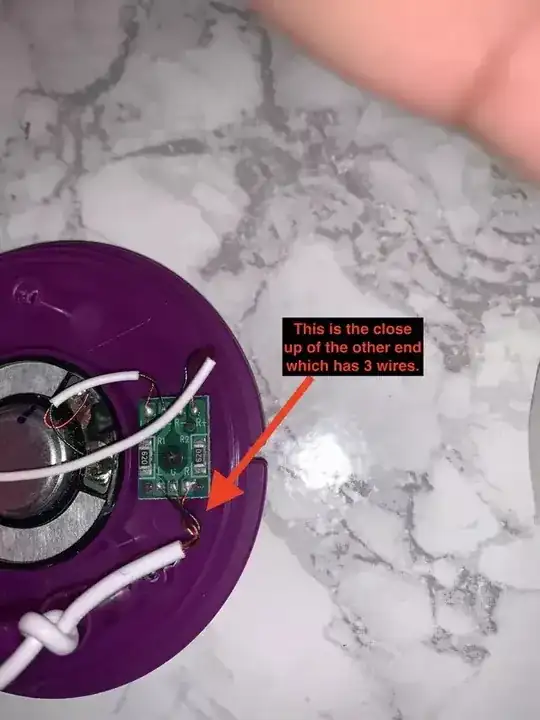

Here is the close up of the other end, showing it has three terminals (or wires):second pic
I am thinking of buying this(https://www.amazon.com/dp/B07Y8KGJKL) from amazon and replacing it. It seems like the right fit but wanted to check with experts here.
I could replace the headphone itself but my kid will break it again, so I need to learn :)

This would work fine. You could also buy a cheaper male-male or male-female cable and cut one end, if you have a wire stripper (can also be stripped with wire cutters or even scissors and a bit of care and patience). The important bit is the 1/8"/3.5mm plug. Just make sure you check which wire goes to L/R/common before you solder. The colors are not standard. You can do this with any multimeter.
