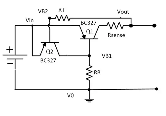

After seeing this schematic in this answer (from @VictorTito ... and others) in this post ...
I was curious to try it ... Added one resistor and I simulated this (?) (DC Analysis) ...

  • This circuit is almost the same except the R_sens resistor (R4) is on the "wrong" side. – G36 Jan 03 '22 at 18:48
  • @G36 Ok. Between 12V and Q2 (emitter) ? Will try. – Antonio51 Jan 03 '22 at 18:51
  • Yep, between 12V and Q2 (emitter). – G36 Jan 03 '22 at 18:52
  • I add the new picture as "edit" which is the "same" as before (?) ... – Antonio51 Jan 03 '22 at 18:57
  • No, move only the left leg of a R5 resistor to Q2 emitter. – G36 Jan 03 '22 at 19:27

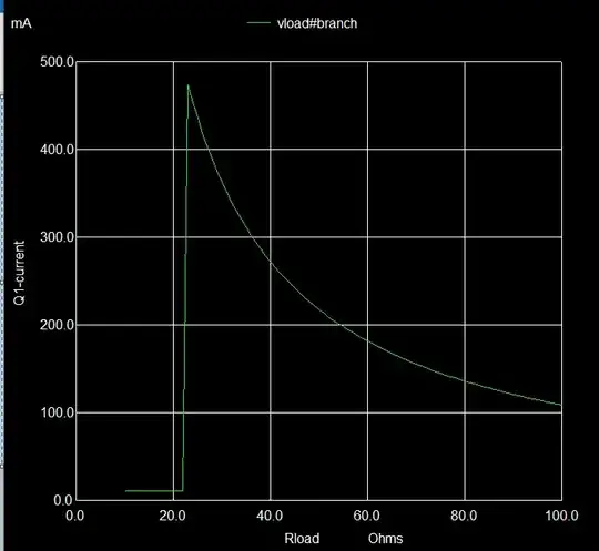

  • Antonio51, RT needs to be higher than RB. Much higher. Make it 1K. For the BC327, make RB 100R. Look at the spice code I provided for these values. Then you perform a dc analysis by changing the Rload from 100R to 10 in decrements of 1 like this: dc 100 10 -1. Then plot the current of v1#branch. – VictorTito Jan 04 '22 at 15:27
  • Antonio51, the transistors are running saturated like a switch, so beta is very small. If you check the BC327 datasheet you will see that beta is 10 for when VCE is saturated. Collector −Emitter Saturation Voltage (IC = −500 mA, IB = −50 mA) VCE(sat) − − −0.7 Vdc. – VictorTito Jan 04 '22 at 15:35
  • @rdtsc R3 is the load. For 500mA maximum it needs to be a little bit higher than (12V-0.7V)/0.5A otherwise the circuit will trigger. Please check the spice code and plot I have provided. It should be easy to understand. – VictorTito Jan 04 '22 at 15:38

Antonio51, Try this one: enter image description here
For the spice test try this one: enter image description here
You should get a plot like this: enter image description here
Please let me know if there are still any more questions.
PS: the circuit is a circuit breaker (like an electronic fuse) and not a constant current limit circuit.

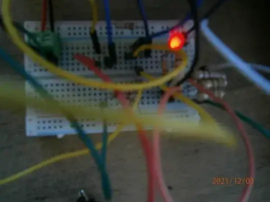

Here are the result of my tests I posted in the original post: Circuit driving 400mA: enter image description here
LED shows that Q1 is ON: enter image description here
When circuit is off, it only draws 50mA which is the current in the Q2 collector and RB: enter image description here

In summary, there are three types of current limit circuits that I know so far:
  1. Constant current limit circuit;
  2. Fold back current limit circuit; and
  3. Circuit breaker current limit. Or current limit circuit/breaker as the youtube video that presented this configuration is called. This is the first circuit in this answer and works with or without Rsense (Rsense makes the circuit more accurate and independent of the different parameters that two transistors of the same type may have. It also makes the circuit independent of the power supply, as with different power supplies you will have different currents flowing on the same resistor value RB.)
As I have mentioned in this answer, and in the original post (also the youtube video describes it better) the transistors need to be running saturated for the circuit to work and resistor RB needs to have a base current such that will keep its transistor saturated for the current the circuit is trying to limit.
For a load current of 500mA, and the BC327, the base current of RB needs to be at least as high as 50mA, as in saturation mode the transistor will be having a gain of as little as 10 (in saturation mode a transistor behaves almost as a fixed resistor and its beta gain have minimum effect as compared when the transistor is not in saturation mode.)
Resistor RT needs to be such that will keep the transistor saturated when it is conducting through RB (50mA for the load current of 500mA).
One more thing. When the transistor is saturated and the circuit on, it is the current flowing in the load that determines the current of the circuit and consequently the VCE voltage drop. Once that current is high enough to make VCE (+ Rsense if it is used) above 0.7 volts, the circuit will switch from “stable” to “unstable” state like in the “equivalent” multivibrator circuit.
