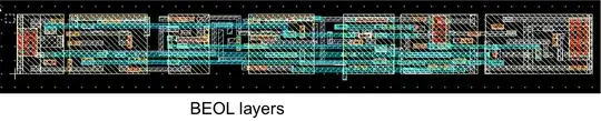

Here is a snap shot of a D_FF layed out in a full custom flow:
  • all layers:
Here FEOL = Front End Of LIne - implants and active area definition
Here BEOL = Back End Of Line - Metals and interconnects
4.8u high
