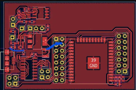

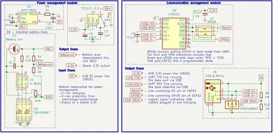

I have some custom PCB with ESP32 uC powered up from Li-Ion with charging system built in. On the board there's also UART <-> USB translating circuit CH430C. It's used for communication with the chip and flashing. Almost everything at first glimpse works fine. Li-Ion is being charged and discharged nicely. CH340C communication works. RST and DTR signals work. ESP works. Problem is such that UART-USB communication works only for few minutes and then breaks - ESP most likely works tho. Oscilloscope readings suggest huge ground instability(1V). Schematic of the circuit is like this: Circuit schematic p1 Circuit schematic p2 Board looks like that: PCB Physical Board What exactly happens? I connect the device to PC and start communication via picocom on Linux. Device booted normally and started to print regular program logging. After few minutes the communication broke tho with an error:

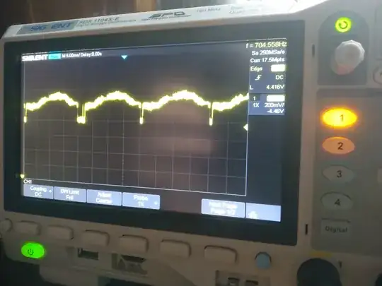

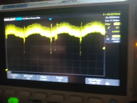

Oscilloscope showed that when additional grounds are connected voltage on the +Bat is stable with subtle wave from the charger. When it gets disconnected the wave gets blurred and much more noisy with chronically distributed 1V peaks.
Unstable behavior without GND Stable behavior Grid is 200mV

The grounding on that board is pretty poor, yes. The ESP32 has really high ground impedance to everything else.
I´d add a second layer on the PCB for a ground plane, then a (or several) vias close to every ground pin, plus some extra via stitching.
To try and make this board work, I'd start by soldering some thick wire something like these blue lines, reducing ground impedance from ESP32 to CH340C and for the USB. enter image description here

  • isn't that ESP32 thing actually a sub-PCB with its own (rather sufficient) ground plane? Otherwise, I'd be missing an antenna. If that's the case, solid ground planes aren't that important, but a direct ground return path would. – Marcus Müller Dec 31 '21 at 13:48
  • Ok. I'll give it a try then and post the results ;-) it's a homemade PCB (termotransfer and dissolving) so vias and double layers are not in the range of my capabilities. I made it only to proove that it's gonna work anyhow. After that I wanted to design and order bilayer PCB. Anyway as I said I'll test it out right away – user8715154 Dec 31 '21 at 13:52
    @MarcusMüller That is true, it's not absolutely necessary that it is a ground plane. But adding a ground plane to a single-layer design is a very efficient and unless very large scale production, very cheap way of creating a good direct low impedance ground path. – Klas-Kenny Dec 31 '21 at 14:03
  • Ok, it helped to improve the stability a bit. For sure it's better and communication gets interrupted less often. Still far from perfect tho because some nasty peaks on the oscilloscope remain and it still breaks from time to time. Anyway i guess all the problem is the grounding. If you have any other suspicions or improvement suggestions I'll gladly hear it ;-) Thanks a lot! – user8715154 Dec 31 '21 at 14:57

The CH340C datasheet says that when using 3.3V supply voltage, both the VCC and V3 pin must be connected to the 3.3V supply for proper operation.

  • Yeah Thanks for noticing ;-) It's done on purpose. I own a sparkfun devboards of CH340C where it's not connected and works pretty well. The datasheet says opposite so i just decided to check it up via trial and wired potential route to solder them up if neccessary :D If you'll look at the 3V pins, from both of them goes wiring to the noticeable pads where they were meant to be soldered together. So far it works in both configurations if the circuit is properly grounded ;-) – user8715154 Dec 31 '21 at 13:45
