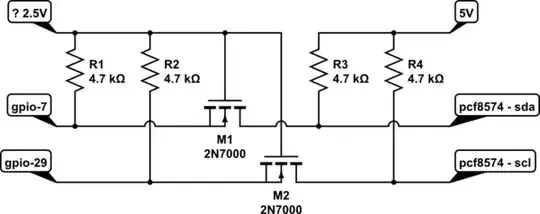

If you're using one of the off-the-shelf I2C peripherals like the LCD display, IO expanders, etc then warning: most of them require 5V, and ESP32 runs on 3V3.
You must not connect the pullups on the ESP side to +5V, but to 3V3!
I've been using this simple voltage translation schematic with success:
"2.5V" on the left should be 3V3, of course, and the gpio numbers are wrong, but you get the idea. You can use any N MOSFET with low capacitance and threshold Vgs such that it turns on properly when about 3V Vgs. The easiest way is to search for MOSFETs with RdsON of a few ohms or tens of ohms, specified at Vgs of 2.5, and sort by price. Here's the one I'm using. Also very neat for driving loads from a 3V3 GPIO.
Since you now have two pullups on each line instead of one, it's a good idea to double the resistor value to get the same current, so 4k7 instead of 2k2 for example.
