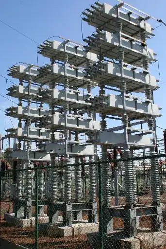

Great answers here on making a nice capacitor, but remember that big capacitors in reality are made up of a set of capacitors connected in parallel. In the image below, each rectangular box contains several cylindrical capacitors, and each four boxes are connected in parallel.
image source: https://commons.wikimedia.org/wiki/File:Condensor_bank_150kV_-_75MVAR.jpg
