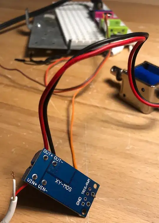

I have a 5V solenoid, and I am trying to power it from littleBits.
I had a littleBits servo bit and cut its wires. The orange wire should be control wire. The reason I want littleBits is because I am using its noise sensitivity bit, which did activate the servo.
I also have a Mosfet switch https://www.amazon.com/dp/B07NWD8W26
In the switch I put a 5V 1A USB power.
The LED on the switch does go on, but nothing moves on solenoid.
I have tried many combinations of wires.
Any ideas how to start debugging?

    Well VIN- isn’t connected. Remember, current flows in a loop. No loop, no work. I can’t see any 0V connection from littlebits either. I think we’ll need a schematic or a least a sketch of how you’ve connected everything. – Kartman Dec 25 '21 at 07:35

    Connected white usb ground to vin out. And tried both red and brown as ground for control wire. Also tried red and brown as control wire with grounds. Nothing – hunterp Dec 25 '21 at 08:41

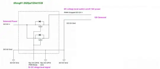

(2) This is a schematic of the MOS switch module:
mos switch

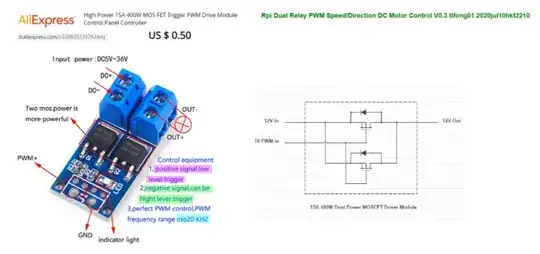

(3) A solenoid can be used to switch on/off a water valve, or as a door lock. A relay can be used to switch on/off a motor or the brightness of a lamp. Their input is sort of a inductive coil. You can read the following schematic to get a rough idea of the control signals.
mos switch
(4) So for a solenoid to turn on/off a water valve, you don't need any PWM signal, you only use a DC voltage level. The simplified schematic is shown below.
solenoid schematic

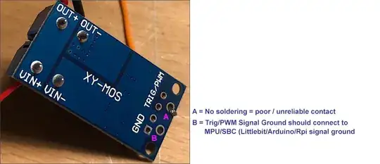

(5) Troubleshooting notes
In you experiment, if the status LED is on, the two MOSFET switches should most likely be on, switching the 12V power to the solenoid. But:
(a) Are are you sure it is a 5V solenoid, not a 12V one?
(b) If a DC 9V battery to used to control the LitteBit's 9g toy servo, which needs 100-250mA typical current during movement https://www.youtube.com/watch?v=5yHcMRPP0Ys, it might not be able to switch on a more powerful 5V/12V solenoid water valve, which usually requires more than 350mA.
(c) One way to verify if your battery is too weak to drive the solenoid which might need 300+ mA, you can replace the solenoid by a 3V~6V toy DC motor, which needs only around 60mA to start steadily moving.
(d) Point to point soldering for reliable electrical contacts.
(e) Short/Connect all signal grounds together.

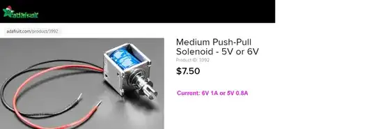

(1) Medium Push-Pull Solenoid - 5V (800mA) or 6V (1A)- AdaFruit US$7.5

    Solenoid: https://www.adafruit.com/product/3992 And im using 5V 1A usb in vin – hunterp Dec 25 '21 at 19:20
    Also connected usb power directly to solenoid...nothing. – hunterp Dec 26 '21 at 05:08
  • Well, your big solenoid takes 800mA, but you small USB can only give 500mA. – tlfong01 Dec 26 '21 at 05:30

    @tlfong01 your drawings of XY-MOS schematics are wrong. With a multimeter you can find that IN+ and OUT+ of XY-MOS are in direct contact. It means that the gates are not on the input lane, as you have drawn, but on the ground lane. This can be important for some applications and can confuse the readers of your answer. Please correct it. – Dmitry Mikushin Sep 05 '23 at 19:05
  • @Dmitry Mikushin:Many thanks for pointing out my mistake. I need to refresh my memory and do the correction later. – tlfong01 Sep 06 '23 at 07:38
