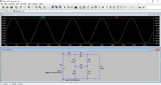

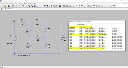

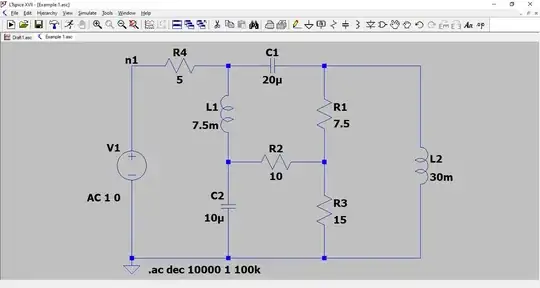

Another way is to simply find a counter-example, since that's what it takes to answer "do all circuits". So, in LTspice, I invented an arbitrary circuit, specifying the value of resistances, inductances and capacitances, I connected it to a sinusoidal voltage source with 0° of phase angle, and performed an AC Analysis sweeping the source frequency through a large range (from 1 Hz to 100 kHz). Then, I measured the negative of the current through the voltage source (since that's the current that enters to the circuit satisfying the passive sign convention in the passive circuit, and LTspice measures currents of voltage sources such that they enter into the positive terminal), and saw the plot of its amplitude and phase angle as a function of frequency. If there is a frequency where the phase angle of the current is exactly zero (and the amplitude is not zero), it means the current through the circuit is in phase with the voltage across the circuit, which happens only if the equivalent impedance of the circuit is purely resistive, so the equivalent reactance is zero.
But after doing all of that, surprisingly there was a frequency where the current phase angle was zero (so resonance occurred at that frequency). This is shown in the following figure.
Figure 1
Figure 1.
Figure 2
Figure 2.

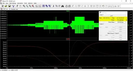

As we can see, at \$f \approx\$ 361.415 Hz the phase angle of the current is zero and so resonance occurs as explained above. We can check this by running a phasor analysis at that frequency:
Figure 3
Figure 3.
Or by running a transient analysis at that frequency (notice the circuit voltage is in phase with the circuit current):

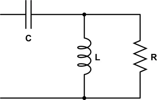

Looks like you are after a form of Foster's reactance theorem (https://en.wikipedia.org/wiki/Foster%27s_reactance_theorem) for lossy circuits, well the bad news is that there isn't one. Consider:
schematic
If my quick analysis is correct, then if \$R < \sqrt{\frac{L}{C}}\$ , the input reactance doesn't vanish at any frequency.

  • I solved the equations for this circuit too and I always got a resonant frequency where the impedance is entirely resistive for all values of R (though I can't rule out that I made a mistake somewhere). However, there is a circuit that doesn't have a resonance for certain component values: (R+L)||C. See: https://en.wikipedia.org/wiki/RLC_circuit#Other_configurations – Jonathan S. Dec 25 '21 at 00:43
  • @JonathanS. I also solved the equation, and agree with Tesla23 that if R^2<L/C, then the input reactance is never 0, no matter what the frequency. However, if R=0, which is less than L/C, then there is a frequency where the impedance is infinite. – Math Keeps Me Busy Dec 25 '21 at 01:25
