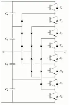

Here is the principle of the circuit:
Circuit
Here is what the output voltage waveform should be like (this picture is copied from an essay and I have got the same result in my Simulink simulation):

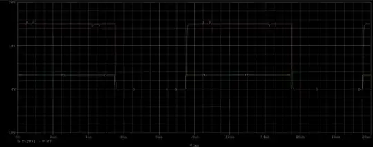

Here is the simulation output of the PWM-driver model (SW3 is the output of PWM generation model, G3 is the input of the MOSFET gate):

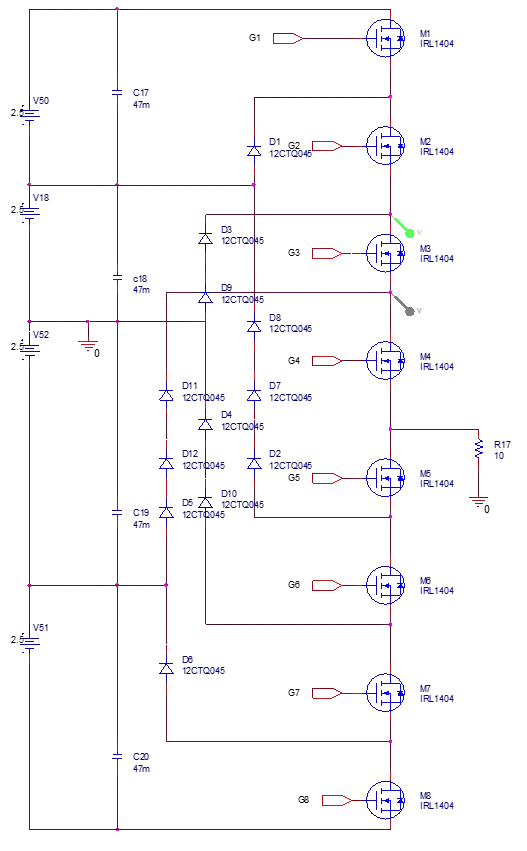

Here is my main circuit; the PWM logic has been tested to be correct, and dead zone has been set as well:

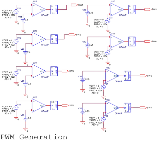

Here is the PWM generation part. Eight channel PWM waves are generated:

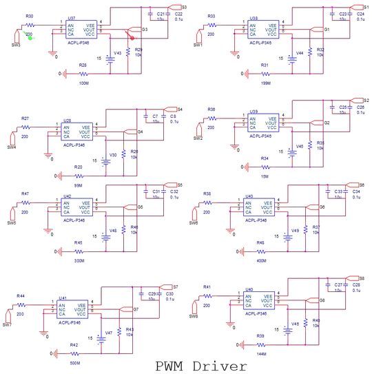

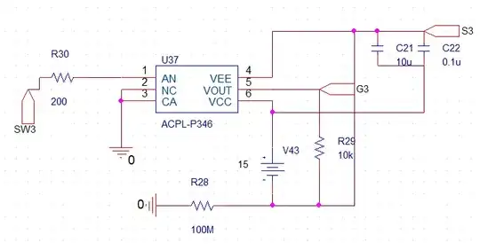

Here is the MOSFET-driver part. Eight optocouplers are used to drive the MOSFETs separately:

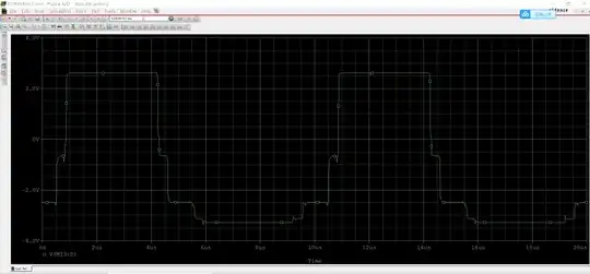

And here is the output wave of my circuit, which looks like a five-level inverter, no more:
I can't figure out what's wrong with the circuit. Does anyone know how to correct this simulation?

    Are you sure that 100M is 100Meg? In my simulator100M or 100m is 100 milli ... Should use 1e8. – Antonio51 Dec 24 '21 at 11:01
  • Why the asymmetry of diodes when you are not using BJTs with forward voltage drop? Is your DC link voltage too low so you aren’t forward biasing the diodes? – winny Dec 24 '21 at 11:02
    +1 on @Antonio51, M is milli in SPICE. Meg is mega. – winny Dec 24 '21 at 11:03
  • emmm, I want to use these high resistances to make sure each PWM driver model has a different GND. – Linda Yu Dec 24 '21 at 11:05
  • Oh, I see, let me change this R to see if it will work. – Linda Yu Dec 24 '21 at 11:06
  • @LindaYu In some simulators, you don't need to add these resistors ... because there is an option that does it for you. – Antonio51 Dec 24 '21 at 11:08
  • I have changed all the M to Meg, But the output wave looks more weired now...I have tested the current in the circuit and the current of D1 D8 D7 D2 is the same as Simulink. But the current of the diode(D3 D9 D4 D10 D11 D12 D5 D6) is wrong – Linda Yu Dec 24 '21 at 11:13
    @LindaYu In a simulation (first try), don't use multiple diodes in series. Keep only one generic with high voltage (say 1 kV) and dynamic resistance low (say 1m). Once the simulation is "good", replace then by the chosen diode. Schematic more simpler. – Antonio51 Dec 24 '21 at 11:37
    @LindaYu other simplification: just use (first simulation) floating voltage generator driving directly G1..G8 (each between Gx and Sx, with correct pulse timing you know). Should use complete circuitry after ... – Antonio51 Dec 24 '21 at 11:44

  • All your "comparators" (provided those opamps have parameters that can be set to make them comparators) are driven, each, by a source, which has the same parameters. That's quite useless. Just use one source for all, since the comparators have different thresholds for the same reference (the sine source).
  • You are using two parallel capacitors for the supply (sources for optos), and one for each DC source. Those are useless in SPICE. On the breadboard, yes, they are needed, but in SPICE, not only two or more caps can be combined to make one, single cap (thus reducing the number of elements for the matrix solver), but a voltage source has zero internal resistance, which means any capacitor directly across a voltage source is useless, unless the current through the cap is referenced (not the case), or you need some capacitive divider (it is the case, but the caps can still be omitted). If, OTOH, you need to simulate some closer to real conditions, then you might need to add some small series resistance to the sources and the capacitors.
  • As @Antonio51 says in the comments, SPICE is not case sensitive, which means that M and m are exactly the same and they both signify milli. In order to make the distinction for 1e6, Meg (or meg, MEG, mEg, etc) is used. Does it make a difference? Yes, because those 15 V sources are meant to be floating supplies, each having the negative terminal connected common with the source of each power switch. That 100meg resistor is meant to provide a DC path to ground for the solver. Some SPICE simulators can deal with that without the resistor, some can't; when in doubt, better use one, if you have problems with the convergence.

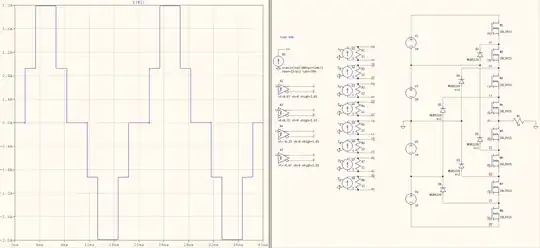

I have LTspice, not PSpice, but just about any SPICE simulator outthere can do it. And with these changes, here is the re-worked schematic:
test
There are a few things that may not look familiar: B1 is my source and it's a triangular wave, to keep with your reference (2nd) image. I'm not using a voltage source with PULSE() because that can only start from negative or positive voltages, whereas asin(sin()) can start from zero. A PWL() could have been used, but I chose this way. Feel free to change that with a sine, or just about any other waveform (don't forget that the thresholds, set by vt, imply the use of a voltage limited to ±1 V). Then, I couldn't find your particular MOSFETs in the LTspice database so I used some other IRL, it shouldn't really matter (even a VCSW -- voltage controlled switch -- could have been used, instead); the same thing for the diodes. I also didn't bother using an optocoupler, using a VCCS and a terminating resistance, instead, to keep things simple in terms of a simulation (otherwise additional transistors should have been added to correct the driving signal, bootstrap diode and cap would be needed, at least). And A1, A2, A3, A4 are Schmitt triggers, normally, but here they're used as comparators. Their output is from 0 to 1 V, by default, and since it's not modified, the VCCS+R combo transforms it into a 12 V driving voltage, with a convenient 12 Ω resistance. The n=X notation simply tells the compiler that there are X series diodes; it's a convenience, nothing more, since the same amount of diodes would be simulated (PSpice may have this, too, it's pretty standard ever since SPICE from 45 years ago). And, finally, if you plot the currents through the power switches you'll notice that there are considerable spikes -- that's because there is no dead-time between the driving pulses (two switches can switch on->off and off->on at the same time, causing cross-conduction). This can be added, too, in the simulation, but must be added in real life (or else!).
If you think it helps, here is the code for the schematic. Save as a file with the extension .asc, and you can open it in LTspice. Don't forget to comment out the .save command if you intend to plot anything else than the current through RL:

  • Thanks so much for your answer. But I want to invert the DC power supply into a 100kHz sin wave(the circuit I posted didn't contain a filter part yet). Will the frequency impact the circuit results? – Linda Yu Dec 24 '21 at 14:07
  • @LindaYu Of course it will. But first, ask yourself: why do you need that reference sine to be at 100 kHz? Is it possible that you need the switching frequency to be 100 kHz, and the output sine (the filtered result) to be 50 Hz (or 60)? If so, you chose the wrong topology. Otherwise, if you really need the sine to be 100 kHz (I can't think of any motive), then you should know that the MOSFETs will need to be driven by far better drivers than simple optocouplers (which will need to be able to switch at those speeds), and you will have considerable losses. Change B1 to a sine source. – a concerned citizen Dec 24 '21 at 14:49
  • I want to use this circuit as an excitation source for magnetostrictive detection. so maybe a 100kHz sin output is necessary. – Linda Yu Dec 24 '21 at 15:02
  • @LindaYu Alright, that makes sense. Just use a voltage source instead of a triangle, but you will need to select good MOSFETs (low Rds, low Q), and fast drivers (it looks like those optos can handle it). You will need dead-time, though, which is not added here. If you can use the schematic in LTspice, here is a way to do it (use the examples therein). – a concerned citizen Dec 24 '21 at 15:17
  • I felt like the circuit is correct but I am still unable to get the correct result. Maybe the MOSFET and diode I chose are not proper? When using four series 3V voltage sources, the output wave should show five-level( 6V,3V,0V,-3V and -6V ). But I only got +2.5V as the peak output voltage..the lowest voltage output is about -3.2V, also the voltage level is not average divided..It is really confused as when I change the voltage source to four series connection 10V, the output is totally wrong, even unable to show the multilevel form.. Is there any suggestions that may help? – Linda Yu Dec 24 '21 at 15:35
  • The MOSFET I used now is IRL540, Vds=100V,Rds(on)=0.077Ω – Linda Yu Dec 24 '21 at 15:38
  • Hi, sorry to bother you again... I got the correct output wave, Now I connect GND to the S-port M8 and the wave is perfect.(Before I connected GND in the middle of voltage source)It is weird...How could this happened? – Linda Yu Dec 24 '21 at 16:06
  • @LindaYu Check the connections and be careful at intersecting wires. For example, when you kept the resistor with the value 100M, what you actually achieved was that you tied each transistor's source to about the same potential through a 100 mOhm resistor, even if you couldn't readily see that due to the nature of the schematic. Without seeing what you have,I can't say anything, but check that when you move the ground somewhere you don't accidentally ground a labelled net; in that case, that net will be ground, not whatever label it had. The same is valid for any other net label. – a concerned citizen Dec 24 '21 at 19:17
