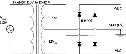

I am reading a knol book on electronics, and I am faced with this schematics:
How do I read a circuit to understand what it does ? Do I have to imagine the electrons flowing, or is there a better strategy ?

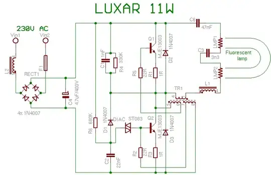

Another example I found, this time more complex:
alt text
While I do understand the left part, how do I make sense to the remaining mess ?

To understand electronics, you first need to understand what the individual components do. There are two parts in that circuit:
  1. The transformer
  2. Diodes (rectifiers)
The transformer can change the voltage of AC (alternating current) power from what you're supplied with (here 120 V, household current) to something closer to what you require (here 12 V).
The diodes (here in a "full-bridge" configuration) convert the AC to DC (direct current) by only allowing current to flow in one direction.

  • That I understood, but I don't really see how the thingie actually straighten the current, and why there is a connection to ground. What I need is to understand the mechanism to discover why it works as a straightener. – Stefano Borini Nov 01 '10 at 21:59
  • Diodes block current in one direction, so half the time one side of the transformer will be high, putting current through one of the top diodes, then other times the other side of the transformer will be high. Click the "full-bridge" link, there's a nice graph that illustrates it. The connection to ground provides a reference point that other voltages refer to. – Nick T Nov 01 '10 at 22:04
  • When you are in front of an unknown configuration, maybe involving capacitors and inductions, how does it work ? Do you think in terms of current flowing ? – Stefano Borini Nov 01 '10 at 22:06
  • First I try to figure out their general purpose, usually either a) filtering or b) power. For filtering parts, imagine what happens at zero frequency (DC) by removing caps and shorting inductors and at infinite frequency by doing the opposite (shorting caps and removing inductors). For power, the parts are usually storing energy (for discretes) or converting it (transformers). – Nick T Nov 01 '10 at 22:15
    So you think in patterns ? – Stefano Borini Nov 01 '10 at 22:17
    At the most basic level, I guess I think about why that part is there at all. Clearly someone put it there for a reason (we hope it was a good reason). – Nick T Nov 01 '10 at 22:31

I'll try to put together the building blocks of your circuit diagram:
  • L2, F1, RECT1, C4: Mains rectifier.
  • R6, C2, D1, C1, R4, DIAC: Start-up circuit.
  • Rest: See this thread.

As long as you don't fully understand the first schematic I would forget about the second.
You say you understand the left part of the second schematic, with the bridge rectifier. The first schematic is also a bridge rectifier, just drawn a bit differently. Just follow the current through the diodes for both polarizations of the secondary's voltage. You don't need electrons, just follow the arrows.
What's added here to the conventional bridge rectifier is the ground halfway between the two output levels, tapped also halfway the transformer's secondary.
The second schematic is complex because of the nasty three windings transformer, and the non-linear diac. Try to understand more simple schematics first, preferably involving just resistors, capacitors and transistors (or MOSFETs). Especially when the transistor is used as a switching element you can go a long way just with Ohm's Law and Kirchhoff's Laws if you know the basic workings of the transistor (i.e. how \$I_C = H_{FE} \cdot I_B\$).
