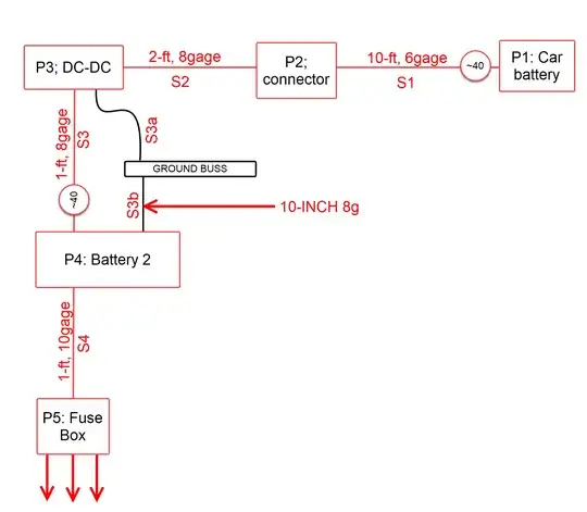

I am working on a project that brings power from a car battery inside the vehicle and to a DC-DC charger. The DC-DC charger then takes the power and charges a second battery. The system is rated at 25A.
The attached schematic tells the story. The DC-DC device comes with 8 gauge wires already. I am wondering if 10 gauge wires can be used on segment S3b.
