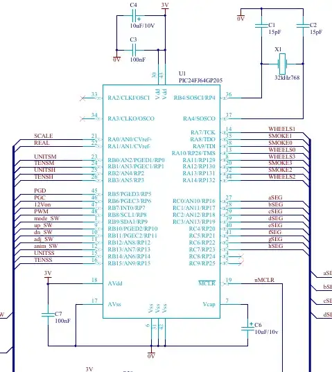

We're designing a simple digital clock and using a 32.768 kHz crystal with a frequency stability of 20 ppm (standard off-the-shelf SMT).
We're finding the clock is running fast by about 2.5 minutes per month.
Now we may have two issues here... we have tracks running under the crystal that might be making the PIC see extra pulses, and we've moved these on our next re-design. But I'm wondering if I should be using a better crystal?
According to the maths, a 20 ppm crystal could be 52 seconds per month out; if we went for a 5 ppm crystal this would be 13 seconds per month. I'm not trying to build an atomic timepiece here, but 52 seconds per month is a bit much, I'd prefer 13.
However 5 ppm crystals seem very hard to come by, most are 20.
Can I ask, what types of crystals do people use when building a normal time clock?
We have another option in the PIC where we can adjust the RTC calibration, but this means we have to read the actual frequency on each unit, not very practical in production!
So what should we be using? A 5 ppm crystal or a 20 ppm and manually adjust each one?
Here's a couple of images of the circuit diagram and layout
schematic
layout

    Are you sure you're using the correct load capacitance for the crystal you've chosen, and taken parasitic PCB capacitance into account? – brhans Dec 18 '21 at 20:06
    Crystals have both initial tolerance and tolerance over temperature changes. Do you have temperature changes? Also the crystal needs to be running in the correct oscillator circuit to run at the rated frequency. The correct circuit includes correctly sized load capacitors. Please post the exact crystal model/order code you bought and schematics and PCB layout to find out any issues. 2.5 minutes in 30 days is about 58 ppm. – Justme Dec 18 '21 at 20:09
  • Thanks, yes we think the caps are correct. We have 2x 15pf to ground. The crystal we're using is this one: https://www.mouser.co.uk/ProductDetail/Micro-Crystal/CC4V-T1A-32768kHz-6pF-20PPM-TA-QC?qs=7bTaA%2FLYtSYW6wr3L2oxGw%3D%3D – Trevor Dec 18 '21 at 20:16

  • Edit your question with a schematic and a screenshot of the layout around the crystal. Having the frequency off by a little bit usually means that your load capacitance is wrong, but you may have also designed your oscillator with too much or too little feedback. – TimWescott Dec 18 '21 at 20:33

  • My apologies for not mentioning this -- in your question, call out the part number of the crystal, or list it's rated load capacitance. – TimWescott Dec 18 '21 at 20:40

    Make at least one of the capacitors trimmable. Also - is there anything odd about the operating temperature - is it unusually cold (or warm)? Tuning fork crystals have qite an odd temperature curve, you may need to take that into account. –  Dec 18 '21 at 23:22
    Data sheet for that PIC suggests there are two versions: one is low-power oscillator that's probably suitable for 32 kHz crystals. The default is high-power oscillator that may be over-driving that tiny crystal. The low-power version: PIC24FJ64GA004 family devices with a major silicon revision level of B or later (DEVREV register value is 3042h or greater) – glen_geek Dec 18 '21 at 23:23

Too long to read all that stuff so, here's the short story
From comments under the question, Trevor says this: -
But, the part linked is a 6 pF device (that requires 2 x 12 pF tuning): -
So, you are probably using the incorrect loading capacitance and, below (the long-story) is how that might change things...

It sounds to me like you need to observe the above and note that you can tweak a crystal into more initial accuracy.
Reminder about the loading capacitance discrepancy
The mouser link to the crystal appears to say that the loading is 6 pF so ideally, that is formed by 2 x 12 pF capacitors and not 2 x 15 pF capacitors. Then, you should probably assume the gate input has 2 pF of capacitance and, that there may be 0.5 pF of parasitic capacitance across the device due to the PCB and its tracking.
All in all, it's looks like you may be over egging the loading capacitance and, quite possibly, you should be aiming for more like 2 x 10 pF and not 2 x 15 pF.
Double check your drive power too because with loading at 2 x 15 pF you might be putting too much power into your crystal (the drive level is quoted in the data is 1 μW maximum.
As an afterthought, if the device is predictably running different to true time, then, you could make a compensation in software. But, you need to be very certain about this so that it's not some long-time-based cyclic drift.

It's high but not silly high. 2.5min/60m/24h/30d=error= 58 ppm. Your datasheet says there are several load options (6.0 7.0 9.0 10.0 12.5) I would not expect them to make them to each , but rather just test and sort into bins of frequency error vs load C and sell them this way...
