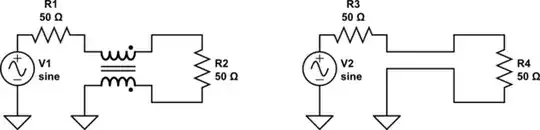

As we need to consider voltages from end to end of the line, we need a reference from one end to the other. Let's avoid the case of the outer being considered the 'inner' of another line with respect to ground, and instead consider the simpler case with the coax looped back so the input and the output are effectively co-sited.
Several things are still true in comparison to the driven inner case.
  • The currents in the inner and outer are equal and opposite
  • They couple no flux to the outside world
  • The differential signal voltage at AB becomes the differential voltage at CD some time later.
  • The only difference is that there is a strong capacitive coupling from the signal line to the outside world.
It's this feature that means we (almost) invariably designate the outer shield as the ground conductor when using unbalanced co-ax. There is as much symmetry for currents in unbalanced coax as there is for a balanced line like twisted pair. The asymmetry only manifests itself for capacitive coupling.
However, there is an inductance for the loop of wire AD. It's a loop, and no magic is happening. There's also an inductance for the loop BC. It's that when we drive AB differentially, we don't couple into the loop AD or BC, because of the equal and opposite currents thang. We describe the inductance from end to end of the coax as a common mode inductance.
Having a finite inductance AD means we can support a voltage AD. The easiest way to understand 'driven outer' coaxial cable arrangements, and they are used in RF components as 'baluns' specifically to use this AD voltage, is to regard the transmission line as a transformer. Here I've drawn what is often known as a 'transmission line' transformer. The wikipedia entry doesn't do it justice, I'm sure an app note from a mixer or balun manufacturer could be found which did a better job.
schematic
By looking at the transformer, we can see that the AD inductance can be equated with the transformer's primary inductance, and BC the secondary. As such, there is no low impedance control of voltage at the far end of the line, for both the inner and the outer!
Note I've not applied a ground symbol at the receiving end. If I ground the lower end of the load, I get a non-inverting transmission line transformer. If I ground the upper end, I get an inverting one, which 'works' for all frequencies where the common mode inductance is significant.
The same goes for the source ground, by reciprocity. I can replace those ground symbols by a direct connection, and choose to ground either side of the transmission line input, or leave both sides high impedance.

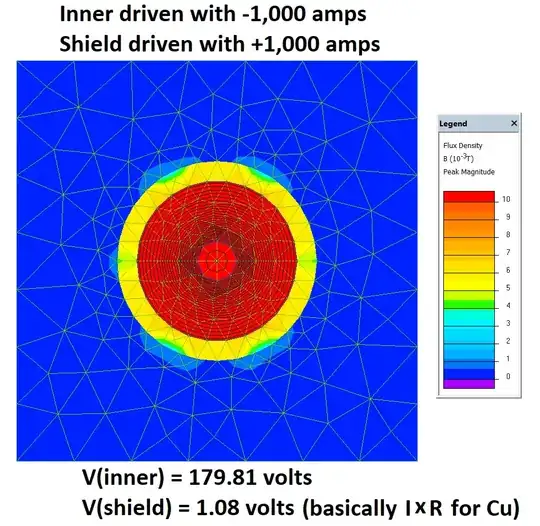

As I showed in this answer, if the currents are the same magnitude but of opposing phase, the magnetic flux density outside the shield is zero. And, we know that from the magnetic theory of current tubes (the shield is a tube): -
The above picture shows the inner (of a rather clumsily drawn 2D model of a coax) driven with -1,000 amps at 100 kHz. The outer (shield) is driven with +1,000 amps and 100 kHz.
The 2D field solver (QuickField) can also be used to measure the volt drops per metre in the simulation. So, across 1 metre of shield there is a volt drop of 1.08 volts RMS and, this is purely due to \$I\cdot R\$; I modelled the conductors using copper and it has a finite conductivity of 59600000 siemens per metre. You can do the math if you want but, there will be a small lossy volt-drop.
But, look at the volt-drop across the inner; it's about 180 volts RMS and, this is solely due to the magnetic field it produces inside the shield. You can see the flux density is "in the red".
And, of course, outside the shield there is no field. This proves that the shield inductance is virtually zero when two opposing currents of the same magnitude are used. But maybe a simulation will help using inductors: -

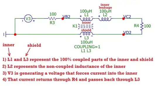

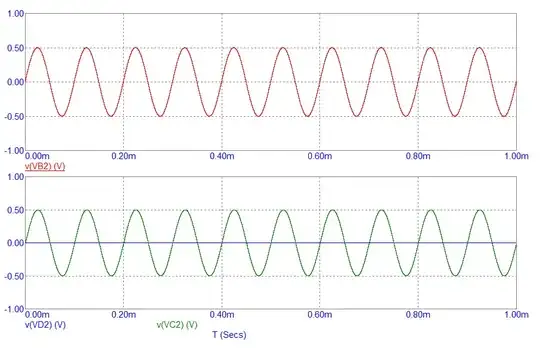

So now, the analysis: -
  • VB2 (the driven inner to the left) is 1 volt p-p
  • VC2 (the output of the inner to the right) is 1 volt p-p
  • VD2 (the shield voltage at the right) is 0 volts
And, of course, the left end of the shield is also at 0 volts.
Given what I've said in the answer I linked, and the clear absence of external flux surrounding the shield AND the simulation, the only sensible conclusion is that, when there are equal and opposite currents flowing in shield and inner, the net inductance of the shield must be zero.
And here's what happens when I drive the shield instead of the inner: -
  • On the left end of the shield is VB2 (1 volt p-p)
  • On the right end of the shield is VD2 (1 volt p-p)
  • They are in phase hence, the net voltage across the shield ends is zero

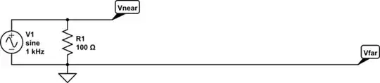

Now, consider the following circuit.
schematic
There is a difference in voltage between \$V_{far}\$ and \$V_{near}\$, but I don't think we would say that there is a physical propagation of the sinusoidal voltage.
