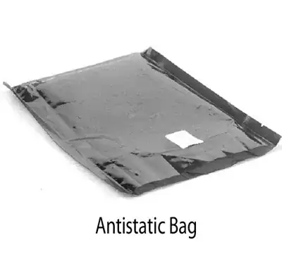

I tested with a multimeter and from the samples I have on my home, that look like this: alt text
They have both internal and external resistances above 2 MOhms for small sections. I even perforated them to see if their interior was conductive, but I don't know if my test reached the inner layer of the plastic (if there is one). Anyhow, the result was the same as for the exterior layers.

    Antistatic bags should be slightly conductive, but if you puncture, crease, or tear them, you'd break the conductivity of the material. – OIO Nov 01 '10 at 16:33
    What does "Above 2 MΩ" mean? Is that the limit of your meter? I tried the inside, outside, and steadily stabbing the lip of a brand new 3M (metallized) bag I have and never got any consistent reading within my meter's range, 500 MΩ, or any significant conductivity reading (< 1 nS). – Nick T Nov 03 '10 at 19:52
    @Nick yes, that is the limit of my meter, but as Jack said, identically looking bags can have totally different characteristics – Jader Dias Nov 03 '10 at 21:24
