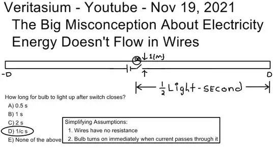

Veritasium - The Big Misconception About Electricity - Energy Doesn't Flow in Wires
Note I do not agree with the answer (D) given by Veritasium which is only plausible if any tiny current whatever is sufficient to "turn on" a source of light. However it may be the power coupling in the given geometry is sufficient to argue that a small source of light would "turn on" in a short interval of time after the switch closes.

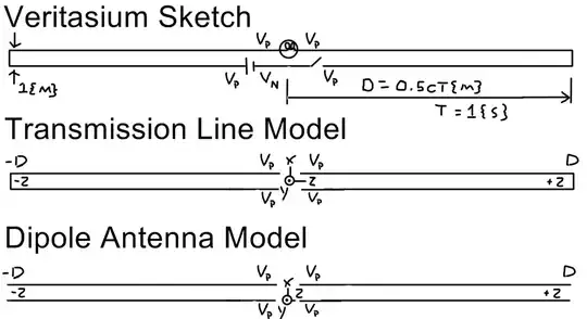

Online responses to the Veritasium video refer to the geometry either as a transmission line model or as an antenna model. I made a sketch of these alternatives as follows:
Applying right hand coordinates the y-axis points at the reader up out of the page. The z-axis extends toward the right of the sketch and the x-axis extends toward the top of the sketch.

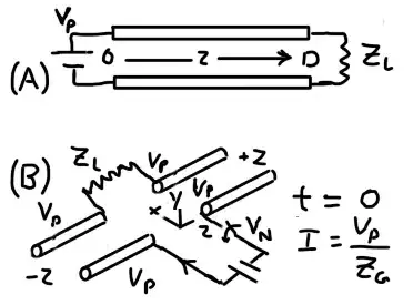

I also made this sketch comparing (A) the text-book model of a transmission line with length in the z-direction; and (B) the approximate geometry of the Veritasium circuit:
The textbook transmission line model (A) does not apply directly to the Veritasium geometry; and the textbook model for a dipole antenna has a sine wave source and a length equal to 1/2 the wavelength of the source. So neither textbook model applies to the Veritasium geometry. I made sketch (B) as the first effort to comprehend how the geometry and properties of materials setup initial boundary conditions when the switch closes at \$t = 0\$.

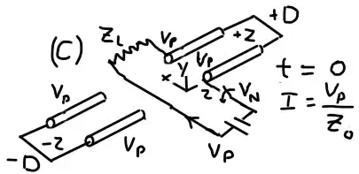

This sketch of an equivalent system model (C), assumed to apply when the switch closes, represents my understanding of the answer by Andy aka:

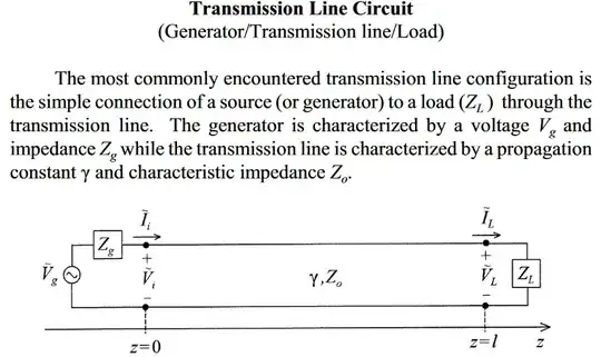

Transmission Line Reference (Added Due to Answers Using TL Theory)
Transmission Lines (53 page pdf): https://my.ece.msstate.edu/faculty/donohoe/ece3313transmission_lines.pdf
See Page 5 (EM Wave Model Corresponds to Voltage-Current Model):
Comment: In my judgment the recognition of voltage and current associated with the transmission line contradict the assertion that "energy does not flow in wires". My recollection is that the material properties of the insulating medium impose a boundary condition on the surface of conductors where power develops and/or energy flows. This boundary condition may reduce the propagation speed along the conductor. The reduction of speed due to the boundary properties of the conductor and surroundings may be used to justify the statement that "energy does not flow in wires" but I think it is not completely accurate.
See Page 17:
In an answer below it appears to me that Andy aka applies this model where the source voltage \$V_g = 1 \$ volt step, this is physically adjacent to the bulb specified as the generator impedance \$Z_g = 100\$, and the end of the transmission line is a short circuit meaning \$Z_L = 0\$. Andy aka estimates \$Z_0 = 600\$ ohms characteristic impedance of the transmission line. There is no attempt to justify the use of this model in the context of the Veritasium geometry and it is not intuitively obvious to me why this model would apply.

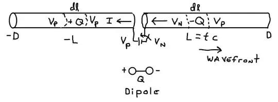

Below is a sketch of the lossless conductor coupled to the battery and switch. I want to understand and apply first principles for reasoning about the initial transient response in the lossless conductor just after the switch closes at time t = 0 {s}. Before the switch closes both sides of the lossless conductor have potential \$V = V_p\$ volt and current in the conductor \$I = 0\$ ampere.
I assume that when the switch closes at time t = 0 {s} the current steps up to a constant positive value, moving toward the left in the sketch, and the voltage wavefront develops on the right side of the conductor as shown in the sketch. The current has a magnitude \$I = V_p/Z_0\$ where \$Z_0\$ is the characteristic impedance based on the geometry and properties of materials in the stated problem. Note however I assume the current \$I = 0\$ on either side of the positions marked +L and -L. I do not know how to calculate \$Z_0\$ for the Veritasium geometry. Therefore I would rather begin the first principles analysis using the long conductor in isolation as shown in my sketch.
Assuming the wavefront moves with velocity \$v = c\$ {m/s} then the length \$L = tc\$ {m} and \$-L = -tc\$ {m} are functions of time. There is a potential difference \$V_p - V_N = V_B\$ moving with the wavefront at position +L where the battery voltage is \$V_B\$.
Note if there is an expanding dipole this means there is a net charge \$-Q\$ moving with the wavefront at \$+L\$ as shown in the sketch and a net charge \$+Q\$ moving with the current transition from \$I = V_P/Z_0\$ to \$I = 0\$ at the position \$-L\$. The length as a function of time is 2L = 2tc. This radiates an external electric field, outside the conductor, which is the field of an expanding capacitor.
If the length of conductor carrying current I is also increasing over time then this radiates an expanding magnetic field. The tendency of current to keep flowing in a long length of wire is associated with the model of an inductor. So the energy state of a capacitor and an inductor, both of length 2L, would be increasing with time provided my intuition about this model is confirmed by a properly reasoned analysis. Then any power coupling of the load (bulb) to this isolated system would reduce the power stored on the source side via negative feedback model.
Electrical power developed by the battery is \$P = IV_B\$ {W} at any moment of time. In an infinitely long lossless conductor the current flow at any instant of time would continue indefinitely if the battery is replaced rapidly by a short circuit. If the dipole model is accurate then there would be no further expansion of the dipole when power source is removed and then for lossless conductor the whole dipole configuration would move to the left with the flow of conventional current as a function of time.
Question
If there an external electric field caused by an expanding dipole region of total length = 2tc then how is this explained using the model for microscopic charge in a lossless conductor?

    The circled answer (D) is the answer given by Veritasium. – SystemTheory Dec 10 '21 at 18:10

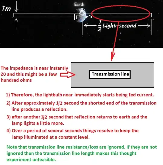

    The answer is wrong. The bulb lights up immediately (at a lowish light output) then gradually increases in intensity in steps taking 1 light second long until it is (virtually) fully lit. Any other answer is wrong. – Andy aka Dec 10 '21 at 18:11

  • It's based on transmission line theory and engineering common sense and decades of experience. I would leave an answer explaining it but, it's not an answer to your specific question @SystemTheory – Andy aka Dec 10 '21 at 18:19
Yes, it does. For example, 2-wire lines (and their physical models) are in common widespread use as: baluns, splitters/combiners, xfrmrs and antenna z-match elements, quarterwave stubs, SWR transducer probes. None of these have a source at one end and a load at the other. The oversimplified source/load topology in textbooks is being used to explain the behavior of 2-wire lines. But 2-wire lines themselves have no such limits. Analogy: a similar topology explains ohm's law, but that doesn't put any limits on using resistors in all sorts of unusual ways not obvious from the models.
Perhaps derail misunderstandings by calling them "2-wire lines" rather than "transmission" lines, because these "constant-impedance extended parallel conductive elements" can accomplish many other things besides basic power transmission.
On the other hand, if we replace the 2-wire lines with meter-long 700-ohm resistors, that's clearly too simple to produce correct results down in the sub-nanosecond scale. If the switch delivers a DC step having a picosecond edge, there will be all sorts of odd phenomena displayed by the large metal structures; effects not seen with simplified resistor model. I think the main one will be the "startup" of the pair of opposite currents in each 2-wire line, accompanied by 150MHz ringing, and a "handshake" effect where each line-current progressively induces an equal/opposite line-current in the adjacent wire. Perhaps many tens of nanoseconds will pass before the long parallel lines finally settle down and behave as pure Zo resistances. After the 3.3nS, the load resistor wouldn't see a clean DC step with a picosecond edge, instead I'd predict something more like an exponential rise accompanied by decaying 150MHz oscillation. But if we don't care about the time-structure of the DC step, we can concentrate on the microseconds-scale result, with static V and I on our Zo resistors, once the ?fifty? nanoseconds of transients have died away.

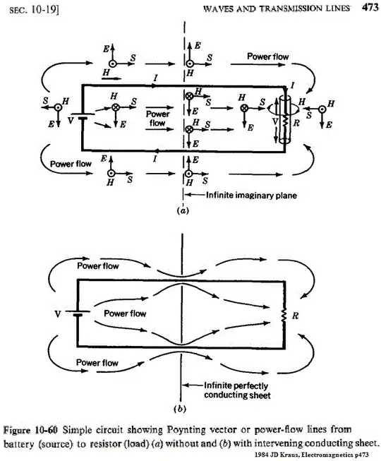

A very early version of Veritasium's diagram is in JD Kraus "Electromagnetics," see enter image description here
...and note that Kraus forces us to confront the fact that 2-wire lines are not RF devices (he employs a DC source: a battery symbol, not an AC generator!) Also, his second diagram demonstrates the unique oddness of 2-wire lines when passing through tiny holes in a Faraday shield. They allow 100% of the EM energy to flow right past the shield, as if it contained a giant hole! The fields squeeze themselves into the tiny gap, then expand again on the far side. Conceptually, this has an unfortunate result: it makes everyone imagine that energy is flowing inside the copper wire, rather than in the space outside the wire. Attempts to block the wires' EM energy-flow with external shield-plates will fail!
That is incorrect or naïve thinking. If you are considering that it is inappropriate because the t-line is terminated in \$Z_L\$ (I presume you mean the characteristic impedance normally called \$Z_0\$), then you need to consider what happens when a t-line is terminated in a short circuit (a perfectly valid case). In other words a t-line can be characterized perfectly accurately using any terminating impedance at any or both ends.

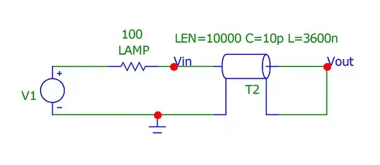

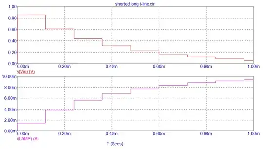

Transmission line model
10 km Transmission line simulation
Simulation of 10 km 600 Ω line (shortened and single-ended example): -
  • Why 600 Ω? 1m is approximately the same distance as old-fashioned telephone wires strung along telegraph poles. 600 Ω doesn't have to be the exact value.
  • The voltage (V1) that feeds the t-line via the 100 Ω lamp is a 1 volt step.
  • The end of the t-line is shorted: -
Points to note: -
  • Straight away (within nano seconds) the t-line acts like a 600 Ω resistor and some current (1.429 mA) "immediately" passes through the lamp. This is important because it basically tells you that the daft video is er... daft or rigged or overly constrained or not-relevant or useless in engineering applications.
  • After some time has passed, the current eventually rises in steps to a value of 10 mA (1 volt / 100 Ω). This is shown in the image above.
Energy and where it flows

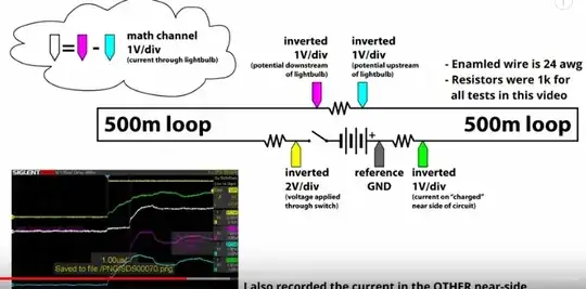

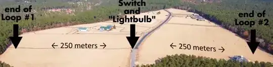

This video by AlphaPhoenix is an effort to simulate the Veritasium geometry and provide measured results. I regard the analysis as an informal and partial answer to my question.
https://youtu.be/2Vrhk5OjBP8
Physical Circuit Diagram:
Circuit Schematic and Scope Probe Diagram (switch is de-bounced):
Expanding Dipole Illustration:
The illustration of the expanding dipole is the same as my question and shows how a dynamic electric field would induce current across the air gap. There would also be a changing magnetic field to support inductive coupling. This magnetic coupling is not discussed in the video.
I regard this as a partial answer to my question primarily due to the discussion of wave interaction of electrons in the conductor via photon exchange of momentum at the speed of light.

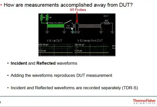

To gain more insight I would be interest to see how a short pulse of voltage and current propagates around the wire with the switch placed at various distances from the battery. The images below are from Transmission Line Pulse testing brochure:
https://tools.thermofisher.com/content/sfs/brochures/TLP%20Presentation%20May%202009.pdf
In the test setup the impedance matching and relatively small scale tend to reduce attenuation loss and signal distortion that are eliminated by the ideal assumption of lossless conductors. Clearly a pulse of voltage and current travels down the transmission line for absorption and reflection by the load or goes around in perpetuity in a closed circuit with no loads or is perpetually reflected in a lossless antenna if the pulse is sent into a conductor with no return loop.
The model for a pulse going down the transmission line is the source does work to charge a segment of the TL as a capacitor and flow current in the inductance per unit length, and then the source of power is removed. The charged secton of transmission line then does work on the next section where there is no loss of energy for an ideal lossless system. The electromagnetic fields and waves are coupled to voltage and current in sections of the transmission line so the Poynting vector, voltage, and current models are coupled in the math model(s).
