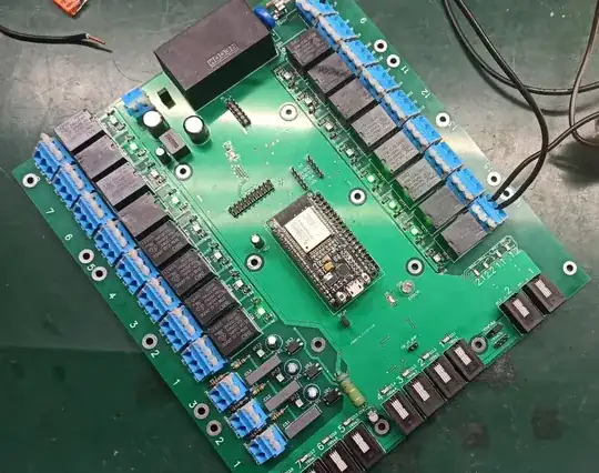

This is a board with an ESP32, 16 relays, and other IO.
I'm using two power shift registers NPIC6C596 to drive the relays...

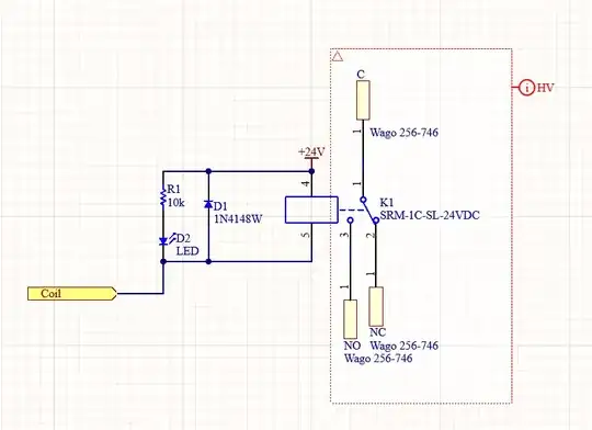

...and here's one relay.

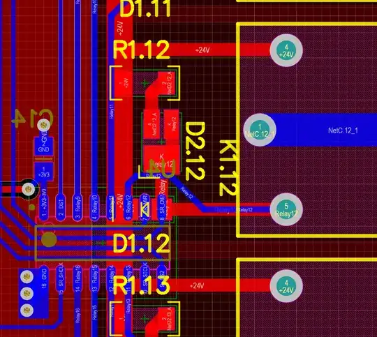

Here's the layout:
+24V for the relays comes from a Recom PCB mount switching brick, there's a canned buck converter to make +5V for the rest of the circuitry.

  • How are your relay ground coils routed w/r/t the shift register grounds? (They look connected together?) You want to decouple as much as possible, dumping the coil ground current without shaking the shift register, I.e. separate grounds. I'm surprised the esp32 is alright: I've had them completely lock up from relay emi. – 2e0byo Dec 09 '21 at 23:45

  • @2e0byo positive pin of relay coil to +24V, negative to shift register. It's a power shift register with integrated MOSFETs, it's supposed to be able to switch inductive loads, solenoids, etc. But then, of course... it has only one ground pin. I'm going to try the TI version (TPIC6C596) to avoid redoing the board... – bobflux Dec 10 '21 at 00:11
  • Bob that won't fix anything to swap drivers. Your loop area impedance from 24V cap to driver to return must be a low inductance to avoid impulse ground shift on common currents induced by loads. V= LdI/dt and L increases about 10nH per cm – Tony Stewart EE75 Dec 10 '21 at 02:01
  • The logic ground must never share any coil current and be directly back to supply pwr gnd. – Tony Stewart EE75 Dec 10 '21 at 02:22

  • @TonyStewartEE75 I'm going to test adding some decoupling caps on +24V. Now I would agree with the comment on grounding, but this chip has only one ground pin, which is both logic and power, so it cant' have a separate ground return for the coils... Well, it looked like a convenient one-chip solution on paper lol. – bobflux Dec 10 '21 at 08:29
