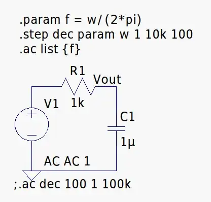

Maybe this is ugly, but it seems to provide the results you want:
The default ac sweep, which gives the result in Hz is commented at the bottom. Also note that the number of steps (100) appears in different places for the two commands.

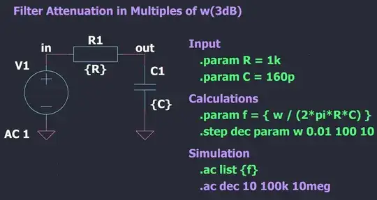

As a complement to devnull's answer above:

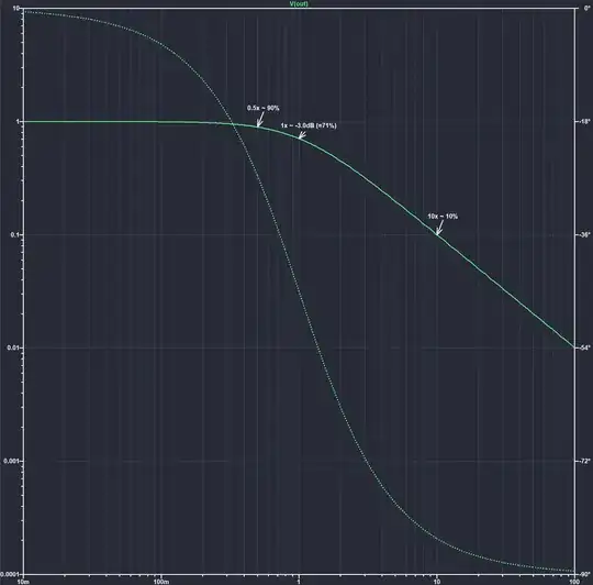

It is also possible to add R and C to the .param f calculation to always obtain the transfer values as a function of multiples of \$\omega_{\,\mathrm3dB}\$ for any RC combination.
Example: Schematic Plot
Read-back

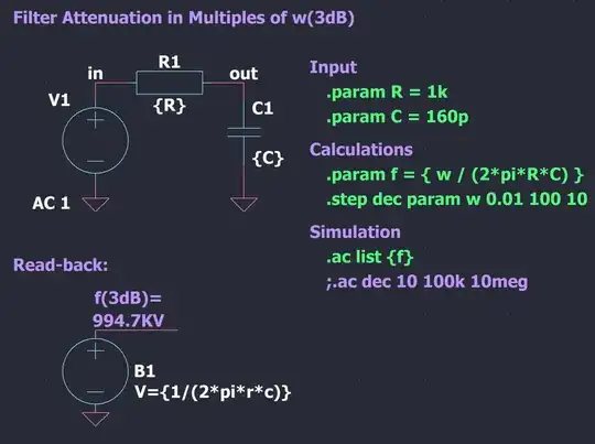

To allow for an easy read-back of the actual \$f_{\,\mathrm3dB}\$ frequency a behavioural voltage source can be added to the schematic. For details on how to do this, please see this: Printing the results of calculated .params.
Don't be fooled by the dimension! I.e. kV should be understood as kHz, and V as Hz more generally. But as far as LTspice is concerned you've created a behavioural VOLTAGE source, so its dimension will be V.
Readback
To get rid of the dimension
If you're bothered about the .op label displaying Volts, you can add /1V (i.e. divide by 1 Volt) to the end of your .op expression to arrive at a dimensionless label.
