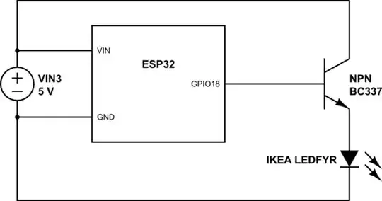

What I have is I think a standard problem in home electronics but I can't wrap my head around it. I'd like to control an IKEA light chain from an ESP32 board. The chain is basically a set of LED diodes connected parallelly. The power cannot be sourced from the pin itself because it exceeds board limitation of 40mA draw (the lights consume 0.72W which is ~144mA at 5V). I want to shift somewhat linearly 0-3.3V from the pin to 0-5V to the lights to turn them on/off and dim.
At first I tried tried using a BC337 NPN transistor but I'm only getting 2.6V max.

  • Well, an emitter-follower is not the way to go. Even if all the rest is right. (Which it probably isn't.) Can you provide a link to the specifications for the LED string? – jonk Dec 06 '21 at 04:12
  • They don't provide anything. There's only a sticker that says 5V DC, 24 x 0.03W. They are powered via USB connector but just connected straight to VCC/GND pins. – mariusz Dec 06 '21 at 04:26
  • So they need a 5 VDC rail and there are 24 of the darned things. So 6 mA each LED, then. Or, as you say, 144 mA total for the string. That is very very doable with small signal BJTs. Just not as emitter followers. Where does the 3.3 V come in? I'm still confused about that. Is that what your ESP is limited to for its I/O pin max output voltage? – jonk Dec 06 '21 at 04:30
  • ESP32 can be powered with either 3.3V or 5V which is later regulated on board. I want to use a 5V input to power both ESP32 and the chain. The PWM-modulated 0-3.3V comes from the GPIO pin I'm controlling with code. – mariusz Dec 06 '21 at 04:39
    So it is regulated *down* to 3.3 V on the board, regardless. The I/O pins can only drive out 3.3 V, I take it. Try grounding the emitter of the NPN. Expect to use 1/20th of the 144 mA, or about 7.2 mA for the I/O pin, which from your wiring appears to be well within its capability. The resistor value should be about (3.3-0.9)/8mA or about a 270 Ohm resistor from the I/O pin to the NPN base pin. Attach the IKEA load between 5 V and the collector. See if that works. – jonk Dec 06 '21 at 04:48
    just swap the BJT and the LEDs in your first diagram. – dandavis Dec 06 '21 at 05:04
  • https://electronics.stackexchange.com/questions/293631/how-convert-a-3-3v-pwm-signal-to-a-5v-pwm-signal https://electronics.stackexchange.com/questions/67775/driving-led-strip-from-microcontroller https://electronics.stackexchange.com/questions/56093/how-to-use-a-3v-output-to-control-a-5v-relay – Bruce Abbott Dec 06 '21 at 05:23
  • @dandavis that worked pretty well, 4.65V output :) – mariusz Dec 06 '21 at 05:35

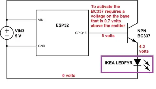

This means that with a 5 volt drive level on GPI)18 the max voltage on the emitter is about 4.3 volts.
Of course, if your supply voltage is 3.3 volts then, the maximum voltage you'll get on the emitter is 2.6 volts.

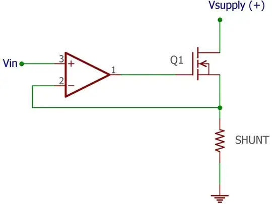

You should try using an op-amp and BJT circuit to adjust the current through the LED: -

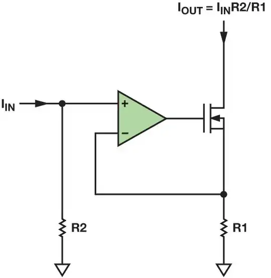

Image from here. The LED would connect between the supply and the drain of the MOSFET above. There's also this version that uses a MOSFET: -
Image from here.
You should also be aware that most LEDs will fail if given too much voltage and that controlling the LED current is a more reliable method.
