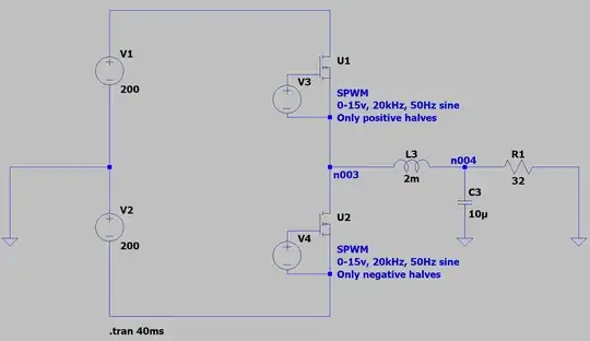

My first idea was to use 3 of these 'half-bridges', that I now learned aren't really half-bridges. not-a-Half-bridge with LC filter

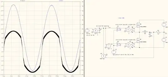

But actually got this: Output half-bridge Red: before LC filter; Green: after LC filter
I now understand that that awful waveform is the result of huge voltage spikes caused by the inductor (since the output doesn't get pulled to 0V) that are being clamped to +200V and -200V by the MOSFET diodes.

    The upper and lower have to be switched complementary - i.e if one if ON the other is OFF with an additional dead time to prevent through conduction. At zero volts output, both transistors have 50% DT. It's not just that one does for positive or the negative half cycyle. – Marko Buršič Dec 05 '21 at 08:23

I understand you want to design this as a three phase inverter, but it looks like your main question is how to make the output less distorted. So, from this perspective, as I mentioned in the comments, the output will be influenced by the control loop. For example, here is a basic half-bridge with a pure voltage mode loop, involving a simple PI filter:
test
V4 is the reference signal, G3, C2 form the loop filter, G4 is the equivalent of a resistive divider voltage feedback, E1 inverts the signal, A1, A2 are comparators for the SPWM, G1, R1, G2, R2 pose as drivers. Instead of V2, V3 you can have a single supply and split capacitors; about the same thing (except different grounding). Here, as it is it's a bit more convenient for the voltage feedback. There's no dead-time, I know.
I kept your values, but a few things to notice: the triangle has a DC that transforms it from bipolar to unipolar, the comparators will need to deal with the negative voltage swing at the input (even if the output will be from 0 to Vcc), and the compensation is done very lazily and without any concern for stability (which you will have if you want bandwidth). For this last reason, the output waveform (blue) is slightly triangular, because the bandwidth is quite reduced. You can see that the error voltage (black) compensates for the distortion. Without a loop you'd be getting the waveforms you have already seen. More bandwidth will get you better waveforms, but also get closer to instability.
For a three phase simply add two more legs (6 transistors in total). You should know that, in general, 3-phase inverters don't consider each phase in particular, but together, through the help of Clarke or Park transformations. This makes it easier to control the outputs, and also adds the possibility of having the inverter act as an active power filter (thus mitigating the imbalance). Also, for "a few kW" you may need to tone down the switching frequency, unless you're willing to spend more for GaN transistors (you'll be switching ~10 A at high voltage!). Not lastly, while the control could be made analogic (it has been done, with great care and maybe even stable results), the way to go is with a microcontroller.
