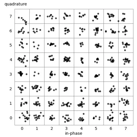

Ben North attempted to play video from a standard audio cassette tape using QAM modulation. First he tested the signal through a loopback cable. The resulting constellation looked pretty good:-
Then he tried recording to an actual cassette tape in an NAD 6220, and playing it back with a Sony WM-EX194. The results were in his words 'disastrous'. Limited bandwidth, amplitude variations, flutter, phase noise and varying motor speed all conspired to make the signal unreadable.
To compensate for speed variations he recorded a pilot tone to one channel and used Barker codes to correlate it to the data channel. Using this technique he managed to get ~24kbps with a 2% symbol error rate. The received constellation looked like this:-
This probably represents the limit for consumer grade compact cassette recorders.
