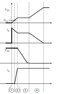

During turn of on an N-MOSFET, the gate drive dynamic characteristics curve looks like this:
  • The gate voltage across the gate terminal of MOSFET rises linearly for charging input capacitance Ciss until the Miller plateau voltage region. The voltage remains constant until Cdg is discharged with the rate of change of VDS voltage and after that, the gate voltage raises linearly again until the maximum applied VGS voltage across gate terminal.
Why is the gate voltage during the Miller plateau region flat?
I am curious about why the gate voltage during the miller plateau region is flat (what forces the Vgs to behave like that - what are the parameters) gate current during that period is also constant (flat.)
In the Miller plateau region, the voltage is constant or sluggish as Cdg is discharging with respect to VDS voltage change.
Why is Vgs flat? (The reason behind this.)

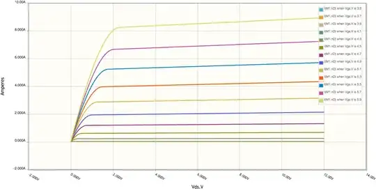

To understand why \$V_{GS}\$ may be constant while a MOSFET circuit is experiencing Miller plateau, it is important to look at the \$V_{DS}\$ vs \$I_D\$ characteristics for a MOSFET.
If a change in the state of a circuit keeps \$V_{GS}\$ constant, then that change MUST involve moving along a curve of constant \$V_{GS}\$. If the MOSFET is in the saturation region during this change of state, then \$I_D\$ must stay fairly level. If \$I_D\$ were anything but fairly level during this change in circuit state, then it would necessarily be the case that \$V_{GS}\$ was not fairly level during that change.

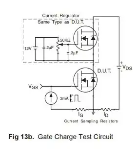

The circuits that manufacturers use to find typical gate-charge \$(Q_G)\$ vs gate-voltage \$(V_{GS})\$, typically control \$I_D\$ and keep it constant during the Miller plateau phase. For example, in this circuit from Infineon / International Rectifier's IRFZ44 Datasheet, the subcircuit in the dashed box serves to hold the lower MOSFET's drain constant during the Miller plateau phase.

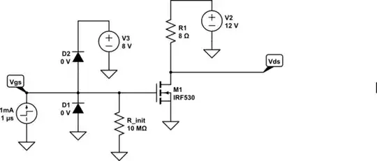

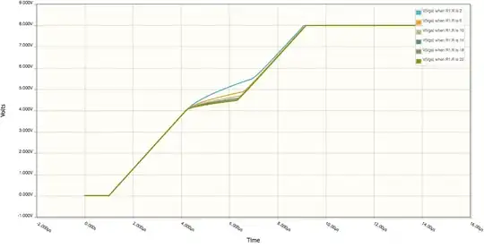

Not all circuits will hold \$I_D\$ constant. As a result, the Miller plateau may be sloped. An example is this circuit with a resistive load instead of a current limiter.
schematic
Here, the Miller plateaux are more or less "linear" or straight, but they are not horizontal. The lower the resistance of R1, the greater the slope of the Miller plateau.
A similar incline of the Miller plateau occurs when the MOSFET drain is connected to an inductive load.
