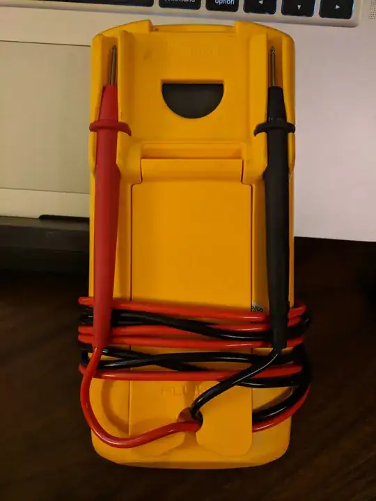

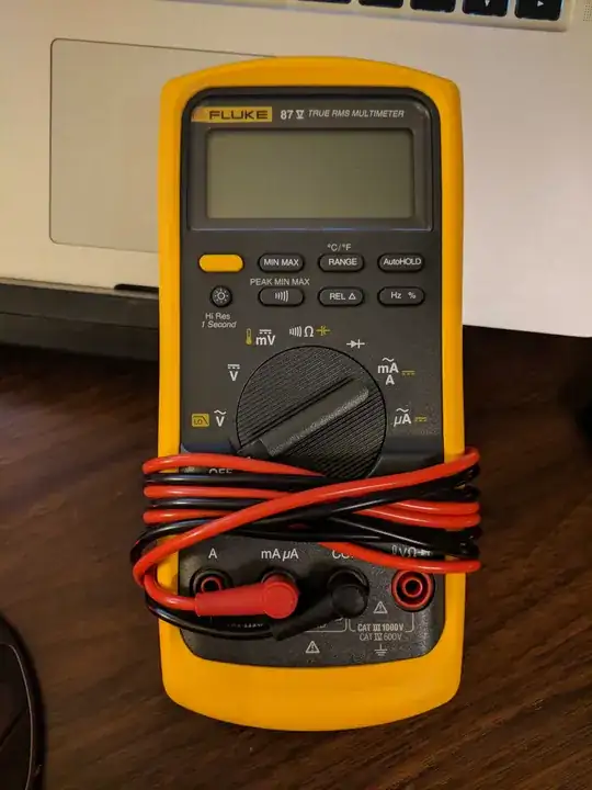

As a long-suffering hobbyist happy to finally have a grown-up multimeter, I was surprised this wasn't more intuitive. I think I've worked out a decent way to wrap it:
Leads remain plugged into terminals, wires wrap around sideways. Start at the bottom and wind your way up towards the dial. For the last wrap across the face, angle back down towards the terminals. Then on the back hook the leads under the lip of the tilt stand and route them out the notch. The probes will just reach their slots with a bit of stress relief and the foot of the kickstand should keep them from unwinding.
It took me a few tries to wrap so there was enough (but not too much) slack, but after getting the hang of it I can wrap it fairly quickly without worrying too much about the precision of it.
I'm not sure if this is less or more stressful to the leads than the alternatives—but to avoid loose, tangled wires without a pouch? I'll take my chances!

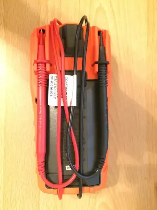

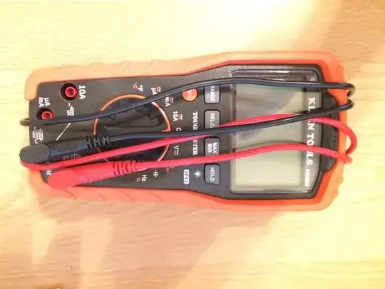

Vertical wrap works great! Check out my pics. Multimeter vertical wrap 1 Mutilmeter vertical wrap 2
I now wrap the leads lengthways around the meter. With the leads plugged in, I start wrapping them vertically, toward the display and down the back side. After two turns, the probes are turned upward and fit perfectly in the slots provided, with the leads having just the right tension. It may help if the leads are not twisted.
