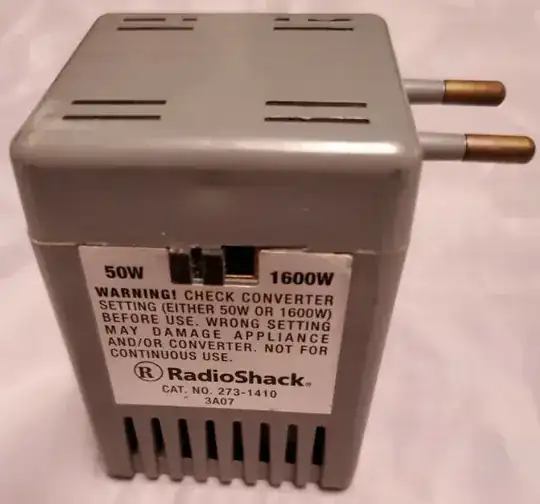

Here's an example of one which requires you to switch between the two:
Here's another which reads:
"1600 Watt Output for Personal Appliances or 50 Watt Output for Small Electronics"
I can imagine that the switch is physically engaging one of two coils, perhaps. But ... why? If it were left on the 1600W setting and someone powered a 50W item in that configuration, what problem would that cause? How do these devices actually work such that this design is important?

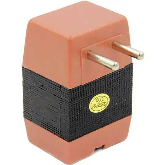

The autotransformer is a 60Hz type similar to this one from B&H Photo in NYC:
It may seem small for 50W but that's because it's an autotransformer (meaning it really only has to deliver 25W) and also it's pretty crappy- it will run warm.

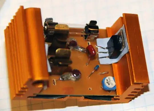

The 1600W portion looks like the below (my own photo)
This is the internal circuit of an ordinary phase control dimmer used for incandescent bulbs with the knob and pot replaced by a fixed resistor (maybe) and trimpot. This is a particularly horrible construction and is not only unreliable but likely rather dangerous- The springiness in the leads is what keeps the triac in dubious contact with the silicone insulator and heatsink.

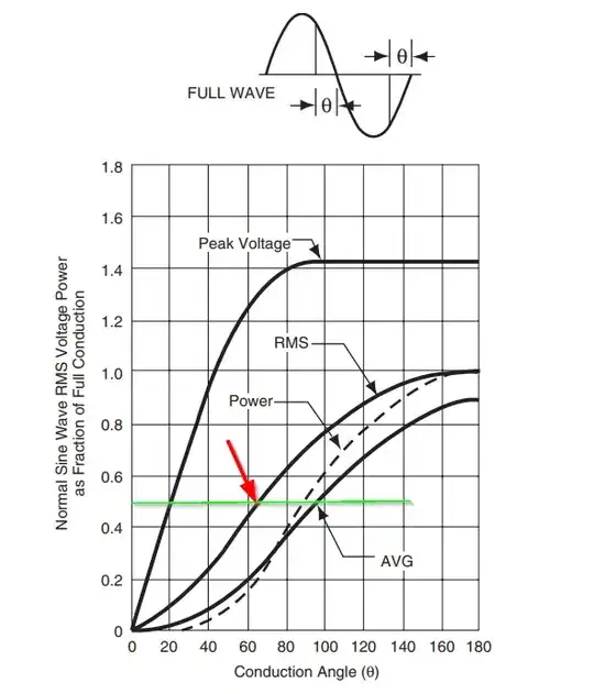

Here is the curve of RMS voltage vs. conduction angle from here: As you can see, the conduction angle has to be ~65° and therefore peak voltage will be around 300V for a 230VAC mains vs. about 168V for a 120VAC mains.
If you run a 120V-only electronic device on the 1600W setting it could well be destroyed because it will see peak voltages well in excess of the rating.

    Is the aposematic orange on that heatsink to remind the user that it is not earthed, so you got to unplug the device without touching it? – bobflux Nov 03 '21 at 20:18
    @bobflux It was purchased for me about 15 years ago by an associate from a surplus place (Active in Toronto for those who remember the Queen Street Gorilla) as a fine example of utter disregard for safety and reliability. Most of the adapter things are unapproved and many are a bit dangerous (missing grounds being common). This one takes the cake though. – Spehro Pefhany Nov 04 '21 at 01:25
