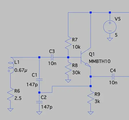

I am a student working on a project where we are using CC Colpitts oscillators as local oscillators.
Image of circuit used
We've chosen the above values based on the condition gm > w02C1C2RL,series, which for the given image translates to gm > w02C1C2R6.
This is a formula we worked with as a given result (assuming biasing resistors are large in comparison to impedances at the resonant frequency), which I gather comes from the feedback network needing to have closed-loop gain > 1 and have the feedback signal be in phase with the input.
I wanted to arrive at this result myself but have been having some trouble. Here is how I have framed the problem and tried solving it:
  1. The feedback topology is shunt-shunt, i.e. I am sampling the voltage at the emitter and then feeding a current back in at the base.
  2. The feedback gain, B = j(1 / XC1), since the feedback input comes into one end of C1 and the other end is grounded for feedback analysis (shunt connection).
  3. Then for an open-loop gain A, the condition of A*B > 1 should allow me to solve for the previous result.
I then tried finding the loaded forward open-loop gain (A), loading the emitter with C1||C2 and the base with L||C1. However, here I got lost in the math and haven't been able to reduce A*B > 1 to the above result after multiple attempts.
I would appreciate any input of mistakes I may have made in the problem setup or help on how to proceed from here if the rest is right.

  • from practical point of view.. why not use a more classical topology with tank circuit between collector and emitter ? – gino Oct 25 '21 at 08:02
    @gino the CC Colpitts is a classical oscillator and is used in many circuits. It's no harder or easier to analyse than any other Colpitts type so, I'm not sure your recommendation makes any sense. – Andy aka Oct 25 '21 at 08:44
  • @LorenzoMarcantonio that paper is for a common emitter Colpitts oscillator and not common collector. It goes all over the place in my opinion and needn't be so long-winded. – Andy aka Oct 25 '21 at 08:49
  • @sarthak it does indeed work - could you clarify what makes the biasing wrong? – kraken234 Oct 25 '21 at 18:02
  • @Andyaka appreciate the link. However, the condition for finding w_0 is one I'd also already worked out. It then gives me the additional information of X_L = X_C1 + X_C2, however that still doesn't help me reduce my expression for gm – kraken234 Oct 25 '21 at 18:18
  • For transconductance, try ${\frac{(C_1+C_2)}{C_1Q^2R_6}}$. Q is simply $\frac{\omega _o L}{R_6}$. My notes for this derivation are buried, sorry. – glen_geek Oct 25 '21 at 20:08
  • @Andyakayou're right wrong topology I removed the link – Lorenzo Marcantonio Oct 26 '21 at 05:45

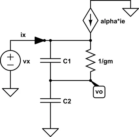

Consider the small signal model of the circuit (excluding the inductor) as shown below:
schematic
Here, I am assuming that, the operating frequency is much higher than the cutoff frequency of the bias circuit, \$\omega >> \frac{1}{C_3(R_7||R_8)}\$, which can be ignored. Also,I assume that \$\beta>>1\$ so that the base current can be neglected and \$\alpha = 1\$. The output resistance and the degeneration are assumed to be \$r_o, R_9 >> \frac{1}{g_m}\$ and are consequently ignored.
With these simplifications, KCL at node \$v_o\$ gives: $$(v_x-v_o)sC_1=v_osC_2+(v_o-v_x)g_m$$ $$v_o = \frac{(g_m+sC_1)v_x}{s(C_1+C_2)+g_m}$$ $$v_x-v_o = \frac{sC_2v_x}{s(C_1+C_2)+g_m}$$ KCL at node \$v_x\$ gives: $$i_x = sC_1(v_x-v_o)$$ $$i_x = sC_1.\frac{sC_2v_x}{s(C_1+C_2)+g_m}$$ $$\frac{v_x}{i_x} = \frac{C_1+C_2}{sC_1C_2}+\frac{g_m}{s^2C_1C_2}$$ $$Z_{eq}= \frac{1}{j\omega C_{eq}}-\frac{g_m}{\omega^2C_1C_2}, C_{eq} = \frac{C_1C_2}{C_1+C_2}$$ This is the impedance looking into the transistor which is a series combination of capacitance and negative resistance. The total impedance including the inductor becomes: $$Z_T = j\omega L+ R_6 + \frac{1}{j\omega C_{eq}} - \frac{g_m}{\omega^2C_1C_2}$$ For sustained oscillations, $$X_T = 0 \implies \omega L = \frac{1}{\omega C_{eq}} \implies \omega = \frac{1}{\sqrt{LC_{eq}}}$$ $$R_T < 0 \implies \frac{g_m}{\omega^2C_1C_2} > R_6$$ This gives the condition you mentioned in the question.
