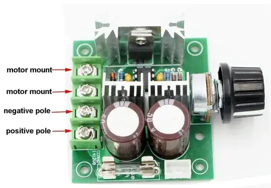

Your PWM controller has "polarity protection" but this does not mean it can accept AC (alternating current, where polarity switches at a frequency). According to the link, it can accept 12 to 40 volts DC input.
PWM Controller
As you've noted, two terminals connect to the motor, and reversing them changes the motor direction. The other two terminals are for DC input, labeled negative and positive.
