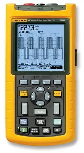

You have the option of using an oscilloscope designed for working on live circuits.
Enter image description here
Figure 1. A Fluke scopemeter is designed to be used safely with its ground on live voltages.
Note that Fluke use a power supply with a high voltage rating between its power supply primary and secondary, a DC jack whose barrel can't be touched when it's in contact with the internal jack socket and an optical link for the RS-232 output.
