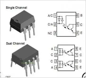

This is an AC input optocoupler:

Having them both in a sigle package, pointing in opposite direction, would, IMO, simplify and make cheaper implementation of simple AC load control.

    @miceuz, from the stevenvh's answer in the pointed thread, I will be needing a special opto-coupler, one with two diods in parallel. My question is further asking if there can be found such a thing, in a combination with a triac output (to drive my triac). I imagine this will be a cheaper and simpler solution than using separate chips. – Vorac Feb 24 '13 at 22:24

I've looked, and I haven't found any devices which combine optoisolators in both directions. You had best use 2 devices.
