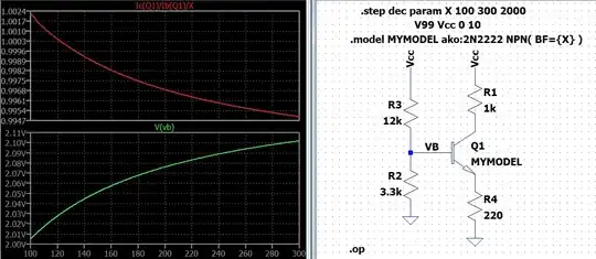

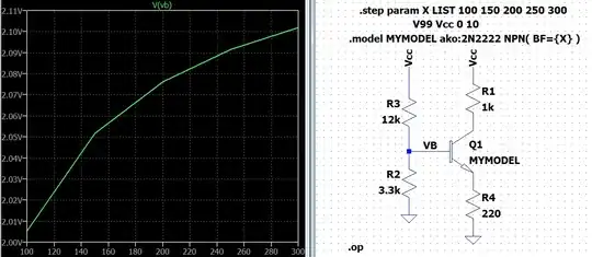

To run a parameter sweep, I usually just use .STEP (this is not the only way, but just one way.) You can then use .MODEL to create your own model name. If you include "ako:" and a starting model name then you won't have to specify all the parameters, as they will be defaulted to the specified model. You can then just focus on changing BF with the new model. Then link your BJTs to that model. Spice will then parameterize your BJT model and perform a run for each step, which you control.
Here's an example so that you won't have any remaining questions about what I just wrote, above:
And finally, here's a slightly fancier way to go. I selected 2000 points per decade, which is over-doing it. But it results in a smooth curve display. Also, I included the ratio of the actual beta to the specified BF parameter, so you can see the variance (in red):
