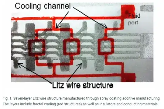

And another use of Fractals, this time Engineered as an improved cooling method is this MRI improvement:
Goodbye wires and formers: 3-D additive manufacturing and fractal cooling applied to construction of MRI gradient coils
Abstract:
The high pulse frequencies employed in MRI gradient and RF coils call for the use of dedicated construction techniques involving special wires and cooling systems. These requirements are needed because conventional (e.g., solid-core) wires exhibit skin effects at frequencies above 10 kHz, which effectively concentrate all the current in the periphery of the wire, leading to heating losses due to high resistance. To mitigate the resistance problem due to skin-depth, many gradient coils (and some RF coils) employ cords of twisted and/or woven thin insulated wires (e.g., Litz wires) that force currents to traverse the entire wire cross-section. Litz wires are hard to configure into the complex designs required for gradient coils, due to a minimum turning radius of several millimeters and the asymmetric bending forces required for winding the wires onto formers. Another challenge in MRI gradient coil manufacturing is the ability to cool RF and gradient coils, especially at high pulse rates. Our approach to this problem has been to replace traditional wire-coil construction methodology with multi-layer additive manufacturing methods, which lend themselves to design and manufacture automation. Additive manufacturing can enable dramatic (i.e., nearly three-fold) improvement in cooling efficiency, through the use of bio-mimetic fractal approaches. Building gradient and/or RF coils layer by layer, we have added conductive, insulating and cooling elements with appropriate interconnects as necessary. A prototype multi-layer Litz wire structure was developed, with fractal cooling, which showed superior performance (in terms of 80% reduced resistive losses at high frequency) to the comparable non-Litz wire configuration.

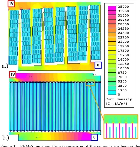

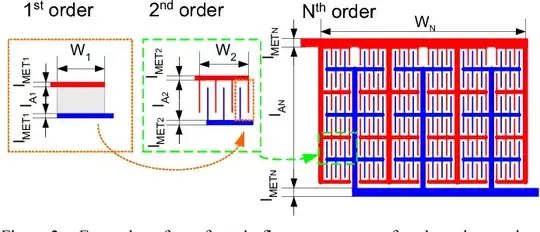

It looks like this paper uses fractals to prevent current crowding in a high power MOSFET.
In high power transistor design, you want to maximize current by minimizing resistance.
Power transistor fractal evolution
If you start with a single basic transistor (fist order) with two metalization finger contacts, the wider the transistor is, the lower the transistor active region resistance is. Conversely, your metalization resistance increases because the fingers are getting longer as. You can increase the metal finger thickness to combat this, but then you're simply scaling the entire structure in both the X and Y direction to increase the current. Instead, if we add fingers to the initial two fingers (beginning the fractal), the active area resistance can drop because the transistor channels are now much wider than they are across. The author then extends this into a 2-D pattern for even more efficiency.
The issue is on-resistance would now be dominated by metalization and the current at any specific section of the transistor would become highly non-uniform as shown in their Figure 3. enter image description here
In figure 3B, they show a comb-structure (2nd order) and show the highly non-uniform current crowding that occurs. To resolve that, they go further beyond 2nd order and add in metalization that's tapered to help support uniform current transfer between each side of the transistor in Figure 3a.

    @Hearth Thermal issues are exactly what the fractal design is working to resolve. Current crowding causes thermal hot-spotting. The fractal design allows more even thermal loading across the entire chip. That does mean overall, this chip will be capable of running hotter compared to a non-fractal design. – horta Oct 10 '21 at 01:46
