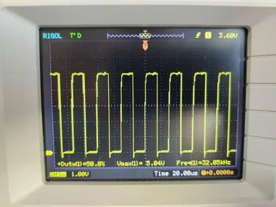

Here is a photo of the broken circuit output after 1-2 months of constant use: enter image description here
As you can see, the frequency at 50% duty cycle is 32 kHz

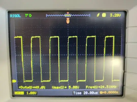

This is now the SAME PCB but with the 555 swapped for a new one: enter image description here
Now, the frequency is back to the required 25 kHz.

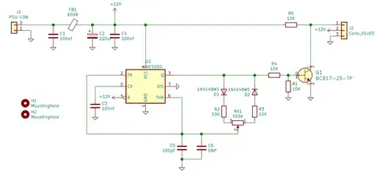

Here is the full circuit for reference (R5 is DNP), previous oscilloscope shots are from probing pin 1 in J2. enter image description here

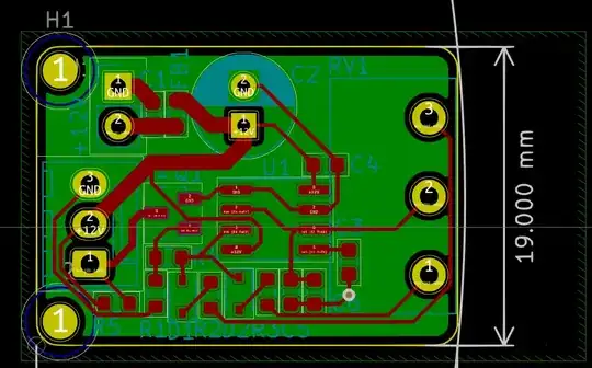

  • The timing capacitor is really 100 pF? Which material is it, NP0/C0G, something else? How is your PCB layout? – Justme Oct 06 '21 at 10:31
  • 82pF to be exact... yes, NP0 82pF ±5% 50V 0603. I'll upload the PCB layout – RWeiser Oct 06 '21 at 10:45

  • I am using this component https://www.ti.com/lit/ds/symlink/ne555.pdf
    Can you link me to a CMOS 555? Why should I use a CMOS 555?

  • the CMOS parts use a P-FET for the top transistor on the out pin this gets a higher voltage on that pin that the bipolar 555 can manage (because it uses an NPN) – Jasen Слава Україні Oct 06 '21 at 11:22
  • The output is driving an NPN, so I don't think that rail-to-rail out put matters... however, it seems that the TLC555 is recommended for "precision circuits" and seems overall more reliable? – RWeiser Oct 06 '21 at 11:37
  • the output is ultimately driving the timing capacitor, so having rail-to-rail output reduces supply sensitivity – Jasen Слава Україні Oct 06 '21 at 12:14

  • 82pF is small compared to PCB parasitics (including flux, dust, charge buildup, humidity, etc). I'd look at increasing it by 10-100x and adjust to a smaller resistor (multi-turn style if you can). – Aaron Oct 06 '21 at 19:30
