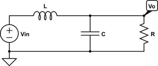

Say I have the following circuit: -
schematic
This circuit has the following transfer function \$H(s) = \frac{V_o(s)}{V_{in}(s)} = \frac{\frac{1}{LC}}{s^2+s\frac{1}{RC}+\frac{1}{LC}} \$.
By definition, we have the damping coefficient \$\alpha=\frac{1}{2} \cdot\frac{1}{RC} \$, and the undamped resonant frequency \$\omega_0 = \sqrt{\frac{1}{LC}} \$. From this, we also have the damping ratio \$\zeta=\frac{\alpha}{\omega_0} \$. Finally, we also have the damped resonant frequency \$\omega_d = \sqrt{\omega_0^2-\alpha^2} \$.
Let's pick arbitrary component values, such that \$\zeta=0.5 \$ (an underdamped case). This occurs when, for example, \$R=1\Omega, \: \: L=1\text{H}, \: \: C=1\text{F}\$. This causes \$\omega_d=0.866 \text{rad}^{-1} \Rightarrow f_d = 0.137\text{Hz} \$. Plotting the step response with these component values gives: -

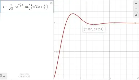

The response has one oscillation, with the period \$T=7.26\text{s} \Rightarrow f = \frac{1}{7.26\text{s}} = 0.137\text{Hz}\$ which matches perfectly our calculated \$\omega_d \$.
So \$\omega_d \$ tells us something about the frequency of the underdamped response. BUT! since \$\omega_d \$ is a frequency, taking the inverse of it gives us (presumably) a time constant, \$ \frac{1}{\omega_d} = \tau_d \$, but in this case it is the period of the response \$T\$. I am particularly interested in the case for the undamped resonant frequency \$\ \frac{1}{\omega_0} = \tau_0 \$.
My question is, do these time constants tells us anything useful about the system? Are they characteristic for the system? The damping ratio, resonant frequency and damped frequency all tell us something about the system and its response. So what about these time constants?
Sorry for the long rant, but I feel this explanation is necessary.

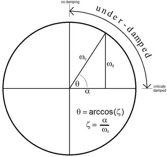

From the above, you may realize that \$\omega_{_\text{d}}\$ and \$\alpha\$ correspond to two sides of a right triangle, with \$\omega_{_\text{d}}\$ related to the sine and \$\alpha\$ to the cosine. The hypotenuse is \$\omega_{_0}\$ and \$\tan\left(\theta\right)=\frac{\omega_{_\text{d}}}{\alpha}\$:

Setting \$\tau_{_\text{d}}=\frac1{\omega_{_\text{d}}}\$ and \$\tau_{_\alpha}=\frac1{\alpha}\$, then \$\tan\left(\theta\right)=\frac{\tau_{_\alpha}}{\tau_{_\text{d}}}\$ and:
$$\begin{align*} v_{_{\text{O}{\left(t\right)}}} &=1-\csc\left(\theta\right)\cdot e^{^{-\frac{t}{\tau_{_\alpha}}}}\cdot \sin\left(\frac{t}{\tau_{_\text{d}}}+\theta\right) \end{align*}$$
\$\tau_{_\alpha}\$ relates to how quickly the oscillations damp out and \$\tau_{_\text{d}}\$ relates to the oscillation period. (Do note that in the under-damped case \$\tan\left(\theta\right)>0\$.)

Here's a plot using Desmos:

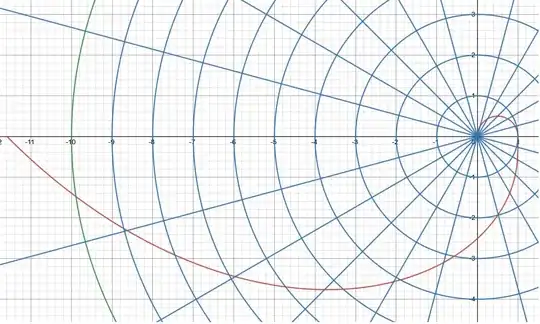

As a last little tidbit, here's a plot of \$0 \le \zeta\le 11.6\$ on a polar graph. The circular region inside the inner circle of 1 is for the under-damped case. The odd spiral beyond that are for the over-damped cases. The angles shift from real-valued to imaginary-valued right when critically-damped. But I just plotted the angles as continuous real values.
For example, when \$\zeta=3\$ then \$\theta\approx -101^\circ\:i\$ and when \$\zeta=8\$ then \$\theta\approx -159^\circ\:i\$.
In the above case, the over-damped angle is developed from Eulers, similarly as shown here, and is plotted as \$\theta=-\ln\left(\zeta+\sqrt{\zeta^2-1}\right)\$.
Anything inside the circle at radius 1 is under-damped. Anything outside the circle at radius 1 is over-damped. (This is the unitless \$\zeta\$, so it is already normalized to \$\omega_{_0}\$. If you want to add units to the above plot, then just multiply the circular rings by \$\omega_{_0}\$ and then the rings illustrate multiples of \$\alpha\$, instead.)
