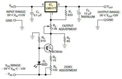

Here's a reference for a 0-3V adjustable LM317 power supply without the minimum 1.2 - 1.3V output voltage limitation.
https://www.edn.com/use-an-lm317-as-0-to-3v-adjustable-regulator/#id2782607-48-a

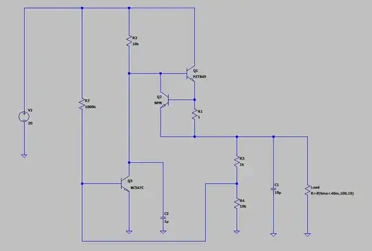

Without using a negative voltage the bottom of regulation range is always dependent of what minimum voltage you are able to amplify (for closed loop control).
  • For single transistor without biasing it is about 0.7v
  • A single transistor with biasing about 0.2v
  • A transistor differential pair about 100mV
  • A rail-to-rail opamp 50mV
Considering the basic follower conception for single transistor without bias (first one mention) at the top of R4 you need about 0.65v to open Q3 to decrease Q1 follower output.

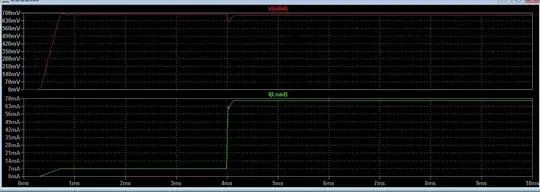

Red is the load voltage, green is the load current (a step from 100 to 10 ohm loading)
A similar, if you change Q3 to rail-to-rail opamp with 50mV reference you are able to move a bottom of regulation range to 50mV.
