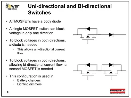

To build the back-to-back configuration using MOSFETs, must the second MOSFET be the same as the first or do I need a complementary MOSFET transistor like in BJT transistors? If I need a complementary MOSFET, please help me with the part number of that.
Uni-directional and Bi-directional MOSFET Switches
Image source: Understanding Modern Power MOSFETs - Fairchild Power Seminar 2006 (PDF)

    do I need a complementary MOSFET transistor like in BJT transistors? Complementary bipolar transistors (NPN and a complemantary PNP) are usually something you would want to use in the power stage of an (audio) amplifier. NPNs and PNPs aren't very suitable for making a switch. MOSFETs are more suitable and generally you would use 2 NMOS or 2 PMOS in anti-series like shown in the schematic above. – Bimpelrekkie Sep 16 '21 at 20:58
The second MOSFET should be the same type (n-channel or p-channel), and almost always is the same part number, although that is not strictly required as long as the ratings and characteristics are appropriate for your application.
Complementary MOSFETs would not work in this scenario.

In the back-to-back connection shown, it's not essential that the MOSFETS be the exact same part, but they do need to be the same type (two n-FETS as shown, or two p-FETs.) The current handling capability and threshold voltage would be determined by the 'lesser' of each FET.
It is also possible to construct a switch using a '4-terminal' FET, which has a separately connected substrate and, with appropriate biasing, avoids having a body diode effect.
