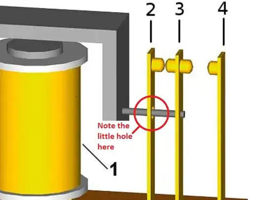

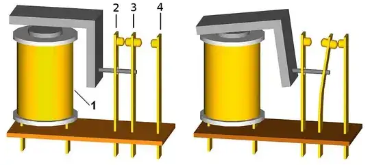

I found this diagram on relays from A Guide To How A Relay Works.
Enter image description here
Why are both 2 and 3 needed? Wouldn't just one be sufficient? I am assuming that when the relay is powered, 1 gets magnetised and gets attracted to 4.

    What if you wanted a light that was on 99% of the time and off 1% of the time? Waste of energy to power the solenoid to keep 3-4 touching 99% of the time. Better to wire your light up to 2-3 and then when you want the light off you only have to run the solenoid 1% of the time – Caius Jard Sep 16 '21 at 20:05

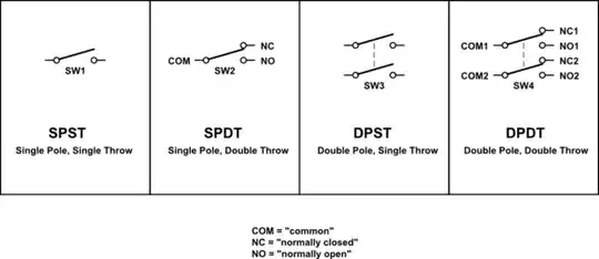

There are lots of different kinds of manually operated switches, all being useful for different purposes. Here are a few, with their names and some nomenclature:
schematic
The number of "poles" refers to the number of indiviual switches that are present in the "package". Each "pole" will be activated by the same "pressing" action.
The number of "throws" tells you how many different connection paths that each indiviual pole can create in its "pressed" or "not pressed" state. For instance, the SPDT switch has two possible "paths", one connecting COM to NO (when the switch is pressed), the other connecting COM to NC (when the switch is released).
The terms NO and NC tell you which path from COM will be "closed" when the switch is in its "pressed" or "unpressed" state. I hope it's obvious that "NO", meaning "normally open", is the path that remains open (disconnected from COM) when the switch is not pressed.

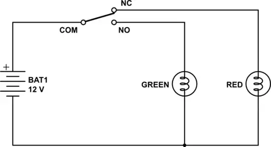

The advantage of double throw switches is that you can control two current paths. In this next circuit there are two lamps, one red, one green. Normally the red lamp is illuminated, but when the switch is pressed, the path from COM to NC is broken, and the path from COM to NO is closed, which causes the red lamp to go out, and the green lamp to light instead:
schematic
simulate this circuit
This behaviour is not possible (at least, not without a lot of extra circuitry) with a single-throw switch.

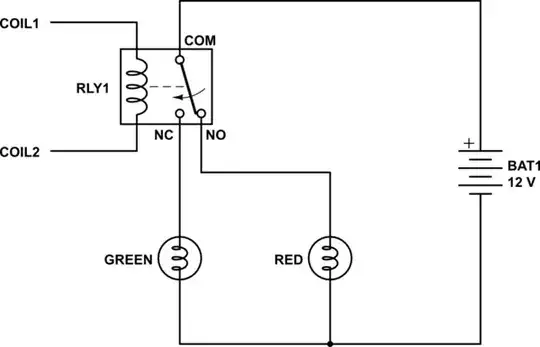

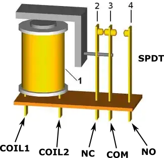

You can find relays with all kinds of switches in them. The one you showed us in your question contains a SPDT switch. Here it is with all the connection names added:
Here's a circuit, using this very relay to control two lamps in exactly the same manner that the manual switches in the previous circuit did:
schematic
You can control the lamps, or any other devices, by switching on and off current in the coil, instead of manually pressing a switch.
When current flows through the coil, the switch is magnetically "pressed", and the current path through the green lamp will close, causing that lamp to illuminate. When you deactivate the coil, the switch returns to its "unpressed" position, and the red lamp will be lit instead.

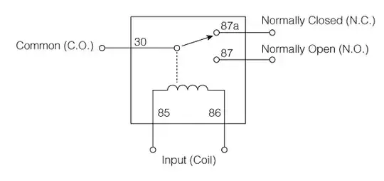

Image from here.
The pin marked "30" corresponds with the middle contact in the diagram in your question. The pin marked "87a" is normally closed when the relay is unpowered. The pin marked "87" is normally open and becomes closed when the relay is energized. If you want to know more about relays, follow the link where the image came from.
The push bar does not make contact with pin 2.

  • I wonder why the picture was drawn that way, rather than with the movable contact being longer than the others, and actuated from a position past the end of the fixed contacts? – supercat Sep 17 '21 at 11:17
  • Artistic licence I guess! – Andy aka Sep 17 '21 at 11:23
  • @supercat Because a lot of common relays are actually built this way. The grey part is usually plastic. No affiliation with the link - it's just a good photo example. – J... Sep 17 '21 at 11:54
  • @supercat Because doing it that way is more complicated mechanically. When the coil is activated, the top of the L moves up or down but you want the contact 3 to move left or right. The simple mechanical solution is a pivot to support the arm where the two "legs" of the L shape meet (and also a return spring, so the relay will work whatever way up it happens to be). A completely different design would be to make the contacts horizontal and above the coil, instead of to one side of it, but the actuator then has to slide, which is harder to design mechanically than a pivot. – alephzero Sep 17 '21 at 13:10
  • @alephzero: I've seen many physical relay designs, but in very few would an actuator have a pin go through a contact. Perhaps simplest is to have the coil horizontal and have a steel slug attached to the moving contact which pivots at the end opposite the stationary contacts. If one wants to use an L-shaped actuator, one could put the pivot of the actuator at the same end as the pivot of the moving contact. – supercat Sep 17 '21 at 14:48

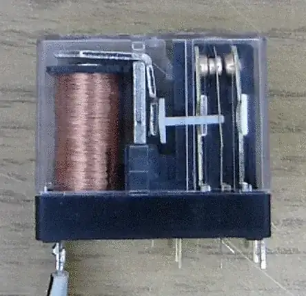

Image source: Instrumentation tools.
What isn't quite clear from the image in your question is that the armature pivots at the top right. The animation shows the pivoting action and almost exactly matches the correct illustration you supplied.
The part that's missing from the illustration is that the relay's ferrous cylindrical core extends down to the bottom of the coil and is attached to another ferrous L-shaped flat piece which provides a path for the magnetic flux back up as far as the pivot point. When the armature pulls in the magnetic circuit is closed, the airgap is eliminated or much reduced and this explains why a relay needs a higher voltage to "pick" than it does to hold or release.
  • 3 contacts 2 when the relay is deenergised.
  • 3 contacts 4 when the relay is energised.
This arrangement gives great flexibility in relay control circuits.
No, neither contact gets magnetised. The magnetic flux is constrained to the core and armature as these have a magnetic permeability about 1000 times better than air.

Relays can be used to switch between two circuits if needed. In your case, when the relay is powered, the connection between 2 and 3 shifts to the connection between 3 and 4. Essentially these are different circuits. Circuit#1 is powered when 2 and 3 are in contact and circuit#2 is powered when 3 and 4 are in contact.
If you are interested, you can also learn more about double pole switches (not an electromagnetic relay).
The way they've drawn it doesn't really make sense.
To make sense, imagine pin 3 being moved to the right, so it's in contact with pin 4 when it's at rest.
Then when the magnet is actuated, it pulls down in the grey arm. The end of the pin from the grey arm extends through pin 2, and is connected to pin 3, so when the grey arm is pulled down, it pulls pin 3 to the left. When it flexes to the left, it loses contact with pin 4, and comes into contact with pin 2.
For this to work, pin 3 (at least part of it) needs to be made of material that's at least somewhat springy, so it can flex back and forth without breaking, cracking, etc. Of course, it also needs to be able to carry the current for which the relay is specified. Pins 2 and 4 are usually thicker, so they'll remain rigid.

  • I don't think you've understood this relay's mechanical arrangement, Jerry. The armature pivots at the top right corner. Have a look at the photo animation in my answer. The drawing is correct. – Transistor Sep 17 '21 at 22:26
  • @Transistor: If it showed a pivot, it might make sense. But no pivot is shown, and without it, I maintain that it makes no sense. – Jerry Coffin Sep 17 '21 at 22:29
