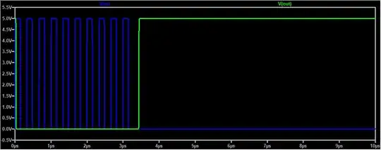

Following my previous question, I came up with the following circuit using 74HC123 for simulation and in practice planning to use this IC. The circuit out should be ON when it waits for a rising edge for more than a time determined by R1 and C1. Hence the output will turn ON when there is a pulse missing(pulse freq is 3MHz):

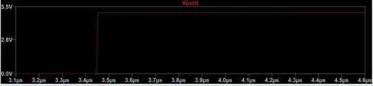

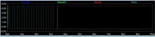

And the time plots for the input pulse train and the output is shown below. As you see the output turns on after a time from the the last rising edge determined by R and C:
enter image description here (left-click to view better)
But now at the very beginning the output turns on as well which I don't want it in real. Can there be a remedy for that? I don't want the relay to turn ON at around time zero when the circuit is powered.
The only thing comes to my mind(which is manual) is to couple the out to a relay after the circuit is powered(?)

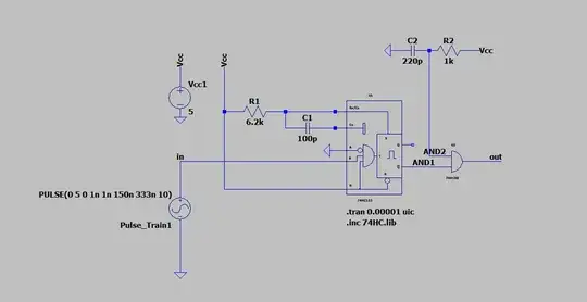

First circuit from Simon Fitch with AND gate and RC:
I also had to set "Skip initial operating point solution" in LTspice.

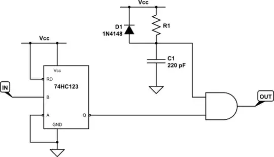

The trouble with using \$\overline{Q}\$ as the main output is that you rely on the monostable being triggered as soon as power is applied, to bring \$\overline{Q}\$ low. Then you keep retriggering as the leading edge of each input pulse arrives.

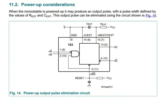

You may get lucky, and have the device power-up in a triggered state, as explained in "11.2 Power-up considerations" on page 13 of the Nexperia datasheet. Otherwise though, if the 74'123 starts in an untriggered state, \$\overline{Q}\$ will be high at power-on, and the only way to automatically trigger the monostable (bringing \$\overline{Q}\$ low) will be to provide some trigger signal as soon after power-on as possible.

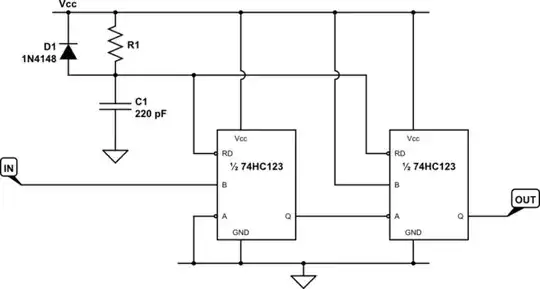

For this reason, \$\overline{Q}\$ will require external gating, if you wish to guarantee a low output at power-on, like this (I don't show timing elements \$R_{EXT}\$ and \$C_{EXT}\$, to keep it clear):
schematic
C1 and the AND gate ensures that OUT stays low for a period of approximately \$R1 \times C1\$ seconds after power is applied. D1 discharges the capacitor immediately upon power-off, and prevents a negative voltage at the top of C1 from damaging the AND gate input. D1 may not be necessary if the AND gate already has input protection diodes.

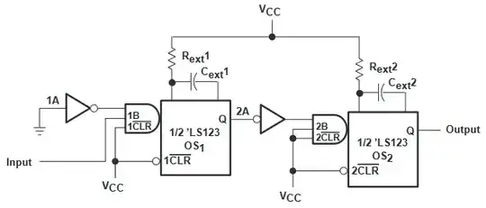

A second problem you may encounter is that the output \$\overline{Q}\$ will go high only until the next incoming pulse. If the pulse is only a little late, then you may find that the output will go high for mere nanoseconds. On page 11 of the TI document "Designing with the 74LS123", they have a "missing pulse detector" circuit which uses both monostables of the 74'123 to overcome this problem. They use the second unit to provide a fixed-length pulse, regardless of the duration of the output pulse of the first unit:
This circuit has the fortunate side-effect of eliminating the problem of an initial high output, because it relies on the falling edge of OS1's Q output to trigger the second unit OS2. You use OS2's Q output, which you know will be low at power-up.
It still suffers from the ambiguous start-up state, but this can be solved with another RC power-on delay to force both units to start up in the untriggered state, as described on page 13 of the Nexperia datasheet:
schematic
simulate this circuit
The above solution also requires only a single IC, which is a bonus. You mentioned activating a relay, so this above solution will also permit you to activate it for some known, controlled period of time, independent of the duration of the detected anomaly.

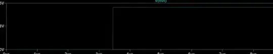

  • When I set "Skip initial operating point solution" in LTspice, your first circuit with AND gate worked. No more initial trash. See my Edit 2 for simulations. – GNZ Sep 15 '21 at 16:48

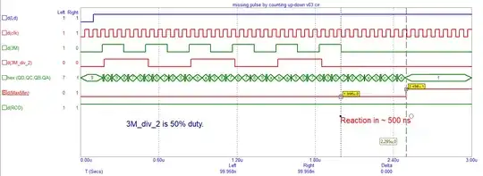

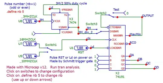

I think monostables are quite susceptible to noise and parasitic impulses. They should therefore be avoided as much as possible for safety reasons. If a simple circuit may be suitable, as proposed in one of the answers, a "FSM" or counter system ... (for pleasure as an exercise or for reasons of choice), for example, could also be used. I am thinking of a prepositioned counter (when starting up) which would count or count down at each clock stroke (10 MHz). The 3 Mhz signal would be used to ensure the direction of "counting". The up / down counter would then be positioned around the pre-positioned "average" value. When the 3 MHz signal (duty 50%) disappears (long 0), it would continuously count down (or up) and as soon as it reaches zero (or 0xF), it triggers the "missing input" signal.
Example of circuitry without "monostable" ... schematic + behavior.
Here is what you can do for eliminating the starting pulse ... Add only reset circuitry.
https://assets.nexperia.com/documents/data-sheet/74HC_HCT123.pdf figure 14
EDIT : Be carefull for "k-map behavior" of this retriggerable monostable. A bit "complicated".
Seems not be very effective ! See k-map, last line !

Edit 2:

  • Does it mean I just need to add R and C for the rest pin? I tried that with different values in sim, it didnt work. – GNZ Sep 13 '21 at 09:02
  • Yes. only add R and C. But problem ? I did not see any value for these components ... Only the fact that it is no input with Schmitt trigger. ("Schmitt-trigger action on all inputs except for the reset input"). So try with a resistor ~ 1k as TTL circuit. R*C perhaps of 100 us ... So C=100us/1000 = 0.1 uF (unless error). I investigate to see if this is enough. – Antonio51 Sep 13 '21 at 09:48
  • What i have found is this note about. I hope this will help. I am reading it ... https://www.ti.com/lit/an/sdla006a/sdla006a.pdf?ts=1631458202807&ref_url=https%253A%252F%252Fwww.google.com%252F – Antonio51 Sep 13 '21 at 10:18
  • Sorry. Nothing seen about these components in this note. If necessary, add a Schmitt-trigger (74LS13 or 74LS14 or 74LS132) gate which will make a clean forced reset at power-on – Antonio51 Sep 13 '21 at 10:37
