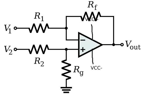

I was planning on using a UA741CP (from TI) as a differential amplifier (to get a current value from a shunt resistor and then administer that value to the ADC of an MCU to avoid noise). However, I noticed that no matter what I did, the output voltage never seemed to go below 1.78 V (when VCC- is grounded).
I do realize that this op-amp was not specifically designed to be used as a differential amplifier, however, the manufacturer did state in the datasheet that the device was a general purpose op-amp and none of the specs mentioned addressed this characteristic. In addition, -correct me if I'm wrong- I assumed that any op-amp would be suitable as a differential amplifier as long as you bias it properly. (1k resistors on each branch would give an output of Vin1 - Vin2, unity differential gain).
Datasheet for the UA741CP:https://pdf1.alldatasheet.com/datasheet-pdf/view/25580/STMICROELECTRONICS/UA741CP.html enter image description here
supply: Vcc- = GND Vcc+ = 3.3 V

  • @DKNguyen I have now posted the schematic, would you please elaborate on why you think that I might have made a mistake ? – A.H.Z Sep 09 '21 at 22:06
    https://electronics.stackexchange.com/questions/304521/reasons-not-to-use-a-741-op-amp – pipe Sep 09 '21 at 22:17
    There's nothing wrong with using a 741 as a differential amp, and it was a perfectly good "general purpose" opamp when it was designed in the last century!!. But what you're looking for is a "single-supply" opamp which the ancient 741 most definitely is not. – brhans Sep 09 '21 at 22:46
    The old 741 opamp's datasheet specs show a 30V supply but some graphs show some of them doing a little from a 10V supply. Its inputs and outputs do not work when the supply is only 3.3V. – Audioguru Sep 10 '21 at 02:28
    @A.H.Z The reason I said that is Vcc is never negative and Vcc- is a bad label. It is Vcc and Vss – DKNguyen Sep 10 '21 at 14:34
  • Just to make sure: are you asking why circuit from uploaded schematic doesn't function as you expect it to? -Vcc connected to the ground, Rg connected to the ground, +Vcc to 3.3V supply? – Kitkat Sep 10 '21 at 17:12
  • more or less, as I said in the original post , I did not expect the op amp to output a stable 2V at the output in a Low condition. – A.H.Z Sep 11 '21 at 16:55
  • @brhans what is the difference between a single supply and a dual supply op amp? in theory they should be the same or am I missing something here ? Also here's what TI has to share on this topic https://www.ti.com/lit/an/sloa030a/sloa030a.pdf?ts=1631361974617&ref_url=https%253A%252F%252Fwww.google.com%252F – A.H.Z Sep 11 '21 at 21:55
    I don't know if there's an 'official' spec for what a 'single supply' opamp is, but the generally accepted minimum spec is that at the very least it must be able to drive its output very close to its negative supply rail - probably within 100mV or less. Better if it can also operate with one or both inputs at or near the negative rail too. The venerable old 741 fails on both of these requirements. – brhans Sep 11 '21 at 22:25
  • @brhans so it can be said that all rail-to-rail op amps are also single supply op amps? – A.H.Z Sep 11 '21 at 22:28
    Yes they are, and single-supply opamps are 'bottom-half-only' rail-to-rail. Some common old examples would be the LM358 or LM324 - both will happily work down close to their negative rail, but neither inputs nor output should or can get closer than about 1.5V-2V to the positive rail. – brhans Sep 11 '21 at 22:34
