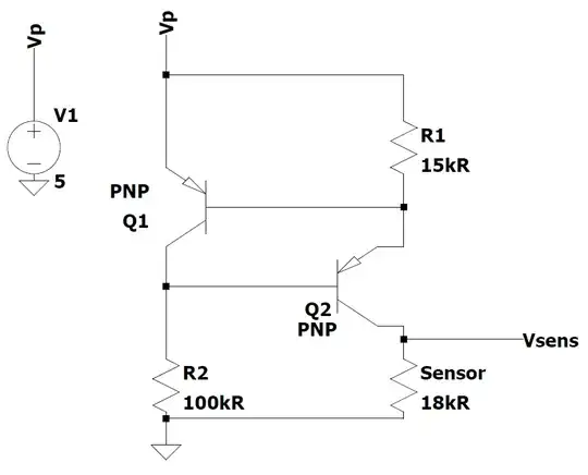

I got this project a month ago and I've been working on it but I just can't seem to figure this out and my professor won't help us. The project is to build a device to correct the patient's walk -in a crude way. Instead of actually "fixing it" I need to turn on 1 or 2 LEDs to show which out of 8 sensors are most pressured. I can only use comparators and op-amps to turn on the LEDs. It's given that only 1 LED can be turned on(the sensor with most force) or if 2 sensors are close in voltages (+/- 10% V) then both of those sensors LEDs would turn on.
Basically I would have 8 sensors on the foot that would measure the pressure and convert it to voltage (linear) which I would use to determine which one is the most pressured one. Now this doesn't have to be a real example so I don't need to worry about which specific component I'm going to use, I need more of a general idea.

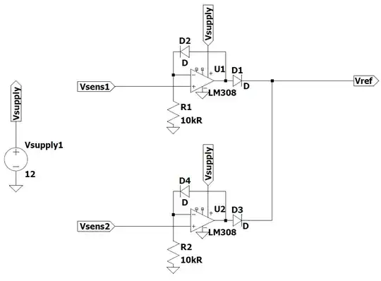

So far I've been able to convert force to voltage using two PNP transistor and getting a constant current source on each of the sensors and I've created a circuit to ,"find" the highest voltage from all eight sensors and only output it, using op-amp and some diodes.

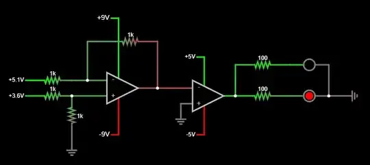

Only problem I have is how to figure out which LED to turn on using comparators and a bit of op-amps and how to add that +/- 10% comparison between all the voltages. When I asked my professor only thing he said, "It is not an interesting situation when the voltages are equal, but when they are sufficiently different, which can be interpreted as improper reliance."
Project : "Based on pressure differences turn on one LED of eight, which shows the approximate position of the foot, that is, which is the most loaded sensor. If the load on the two sensors is equal (in limits +/- 10%), two LEDs should be switched on. Make a signal to turn on the LEDs using differential amplifiers and comparators that compare the difference of two voltages with zero, and if the difference is less than zero, turns on one, and if it is greater than zero, turns on the other LED."
Constant current source Constant current source Finding the highest voltage Finding the highest voltage Some idea I had about the LED logic using diff op-amp and a comparator Some idea I had about the LED logic using diff op-amp and a comparator

  • @Transistor Ah yes, here it is https://imgur.com/a/kkxPhjN. I created a constant current going through the sensor and giving me linear voltage compared to force. Then I would find the highest voltage out of 8 and forward it to diff op-amp as Vref and connect voltage from the sensors, get a Vsens - Vref and then output of that would go to a comparator and compare that voltage diff to 0 and based on the sign I would turn on LED.Problem I have is that doing that I have always 4 LEDs turned ON. Here is my idea for that https://imgur.com/a/hsB1W5V – Chris Sep 05 '21 at 23:25
  • @jonk Well sort of "The sensors are resistant, linear and identical, resistance 18 kΩ when unloaded and with a positive slope of 2 kΩ / kg load.". That's all we have but I just ran a constant current through the sensor and got linear voltage compared to force applied. – Chris Sep 05 '21 at 23:28

  • @Chris I have some thoughts on your current source design that you may want to compare with your own thinking. Don't know if it is useful to you. But it might be worth a moment. As far as the eight sensors go, are you summing those into a single node? – jonk Sep 06 '21 at 00:32
  • @jonk My idea was to find the highest voltage the forward it to 8 differential op-amps with voltages from sensors which would give me difference between all the sensors and the reference voltage ( highest voltage), and then I would send that difference of voltages to window comparator that would have window of High (Vref) and Low (Vref - Vref * 0.1). – Chris Sep 06 '21 at 00:33

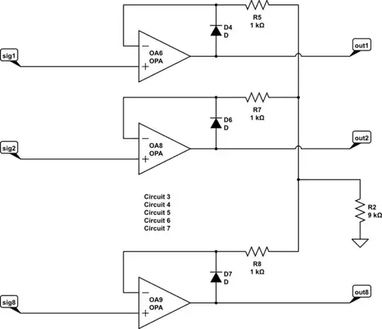

  • @Chris Why not sum them? It doesn't seem right to me that you'd "find the largest." What's the thinking behind that approach? – jonk Sep 06 '21 at 00:34
  • @jonk I...don't know. In the project it said find the most pressured sensor so my brain jumped to pressure = voltage so most pressured = "most voltage". I didn't even think about summing them up. – Chris Sep 06 '21 at 00:39
  • @Chris Assuming that these sensors are linear with weight applied, it would seem better to sum them. Different feet have very different structures to them and how load is placed is very different, one to another. Well, at least, give it a thought now. I'd tend to imagine summing is better, before taking a difference, than taking the larger. It's also easier to achieve, I think. Your approach "picks one." The summing is effectively an integral/average and that's less noisy and I think generally closer to what you want, anyway, separate from noise considerations. – jonk Sep 06 '21 at 00:44
  • @jonk I'm guessing that I would use Non-inverting Summing Amplifier for that so I have to see how it works when all the outputs are ON since I didn't really use it that much last semester. Still, I need to figure out how to turn on the correct LED. – Chris Sep 06 '21 at 00:54

This is highest and "within 10%" finding circuitry.
