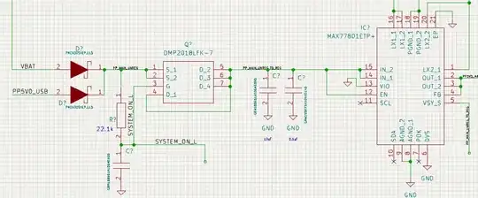

To make everyone's life a little easier:
schematic
The output of the buck-boost is 3.3V with peak consumption estimated at 1.5A. The Q thing is just a beefy p-mosfet to be controlled by physical switch, irrelevant, imagine it's not there (it's only development stage anyway, everything is subject to change).

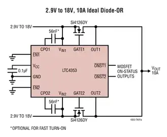

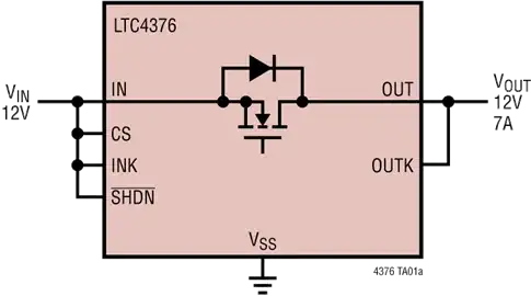

Is there a way to make power rails with such current meet with less power loss than I'm looking at now?
Consider looking at PowerPath, Ideal Diodes, and Load Switches from such vendors as ADI. For example this one, the LTC4376: -
Basically it's a MOSFET used as a near-ideal diode. You can even get two of them in one package I believe thus forming the diode-OR functionality it appears that you need. The LTC4353 has two in one package: -
