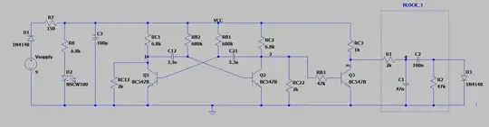

I'm new to LTspice so I would like to have a few ideas. Here is a circuit:

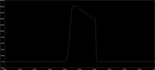

Basically, the output of BLOCK_1 is a small triangular waveform. I need to pass this output through a 1N4148 diode which is a test device. The current which I get through it is:
Essentially, this is what I obtain after using the current probe of LTspice.

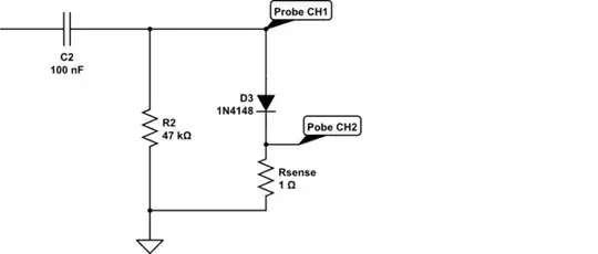

How do I do that if I connect a resistor in series to D3?
Like this:
schematic
Then Channel 1 will give you the voltage across the diode
Channel 2 will give you the current through the diode
As Rsense has a small value, the voltage across it will be very small. So much smaller than the voltage across the diode that you can ignore it (assume it is zero).
If you're nit-picking then use the subtract function on the oscilloscope and subtract the voltages: Vdiode = Vch1 - Vch2
Maybe the current through the diode is small making the voltage across Rsense also small. Then simply use a larger value for Rsense, like 10 ohms or even 100 ohms.
Aim to keep the voltage across Rsense below 100 mV so that the diode voltage will not be affected much by that voltage.
