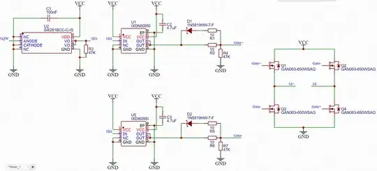

I am in the middle of doing some research on gate driver ICs and I'm wondering why it is more common for people to use two half bridge driver as apposed to using two gate driver ICs.

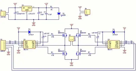

Here is the more common approach:
(credit https://320volt.com/en/h-bridge-dc-motor-driver-circuit-with-ir2101/)
and here is the approach I was intending to use:
Is there something fundamental that I am missing with my design that will cause me issues when I try to power my motor?
  • Yes. Your approach CAN be adapted to work for restricted supply voltages and PMOS high side switches; but otherwise you need different voltages to correctly drive all the gates. –  Aug 18 '21 at 12:37
Absolutely. Your second circuit that attempts to share common drive signals to (say) upper left and lower right MOSFETs cannot utilize bootstrapping and this means that the upper MOSFET will never turn on properly.

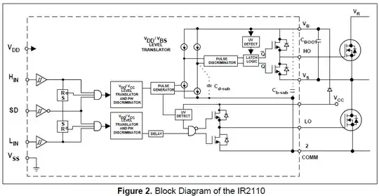

In your first diagram, both upper MOSFETs were driven by a bootstrapped driver and that allows their respective gate drive voltages to rise around 10 volts higher than the 24 volts feeding the H-bridge shown in that diagram. This makes a really big deal. Inside a bootstrap driver: -
Picture from here

  • thankyou for the links! But why would the top left MOSFET not turn on properly? From what I can tell from my circuit diagram, when the top gate driver is outputting high, then the voltage on the gate of Q1 and Q4 will be Vcc with respect to the ground.
    Is it because the source pin of Q1 is not actually connected to the ground but is instead referencing the drain of Q4 through the load?
    – Luke Bradley Aug 18 '21 at 11:51
  • @LukeBradley exactly. The top MOSFETs are source followers hence, to turn on the MOSFET properly the source would have to be between 3 volts and 10 volts below the gate voltage AND, given that the gate voltage is at Vcc, the MOSFET's source has to be at least 3 volts lower hence, it cannot be fully turned on and conducting good from the Vcc rail. – Andy aka Aug 18 '21 at 11:57
