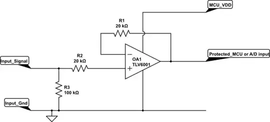

The Rogowski coil is a voltage output, BUT you must protect the A/D input of the Arduino from potential overvoltage. You need to add a voltage limited OP amp (or some other active clamping circuit) to the input and connect the sensor to that.
This will work:
schematic
The TLV6001 is rated for rail-rail operation and so allows the full range of MCU or A/D input ...in addition it is rated to carry 10mA in the input protection diodes. This would allow the configuration above to withstand voltages of +/-200 V on the input resistor R2 (providing your resistors are rated for this voltage).
Since the TLV600 is powered by the MCU +5 V supply it cannot produce an output voltage above 5 V or below 0 V, so the input is accurately clamped WITHOUT impacting the A/D range at all. You must make sure that your MCU solution is always drawing a minimum current greater than your expected protection current (this is only an issue if you put things into a sleep state). You can select the input resistance needed by simply changing R3. This should work for both 3.5V and 5V Arduino variants.
