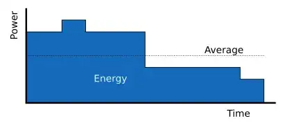

Figure 1. Energy is power by time. The average power is measured in units of power (W), not watts/hour.
Average power is just total energy consumed divided by time and is measured in W or kW.
